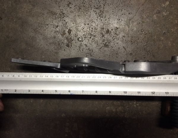

While looking at installing the tragkorb brackets.  Discovered my right peg plate is bent pretty badly.  About an inch.
Also discovered Right plates are non-exsistant on ebay.  Hooray.  They got like 10 left plates.  Found the ONLY available, mis-match Right k100 plate I believe will work w a bit of hole drilling.  So I will have a spare of sorts until I can find the correct part.
The tragkorb bracket should be mounted behind the plate.  Ugh.
One option...With a bit of grinding on the tragkorb bracket I could make it work bolting it to the front side of the plate.  However I would have to completely delete the rear foot peg.  AND I do have the solo seat on it.
Moving forward w option 2... I bolted a make-shift pry bar to the rear foot peg hole.  And began gently pulling it.
I think we all know where this is headed.
Yep, cracked it.  But now its straight and as luck has it.  I am buddies w the worlds greatest aluminum welder, just down the hallway at work.
So, It fits really nice now.  Will drop it off w Gary tomorrow.
Also found what was making that occasional pesky little squeak in the rear end.  The spring was just kissing the rim.
So got that taken care of.
Over all a pretty productive weekend.

" Right plates are non-exsistant on ebay.  Hooray.  They got like 10 left plates. "
Wait until next week, or did all of the Ks crash and fall over to the right?
Unistrut jigging is a good thing. Bike is looking oh so clean!
Don in Nipomo

Yes, these bikes have a strong tendency to fall to the right, probably because the sidestand is on the left.  It is not just footpeg plates.  Just search eBay for mirrors, fairing lower panels, and side cases.  Left side components outnumber right by at least 5 to 1.

Got the plate welded up.  And I may have to fix a water pump leak.
