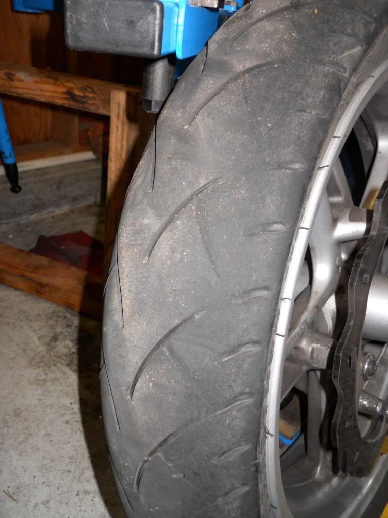

New Tires ... Pirelli is phasing out my favorites, Angel STs and now makes an Angel GT ... suposed to be better and longer lasting ... yeah sure.
I know JO loves his ME880s, but here are a few pics of my experiment with them.  3200 miles is all I got out of these and they look like this.
This is the back, not sure you can see it in the pictures but there are chunks of rubber missing out of the edge lips of the tread groves.  I have never seen this before and it is very disappointing .. I was hoping these would be good Iron Butt ride tires, but I get almost twice the mileage out of sticky, better handling sport touring tires ... done experimenting for a while.

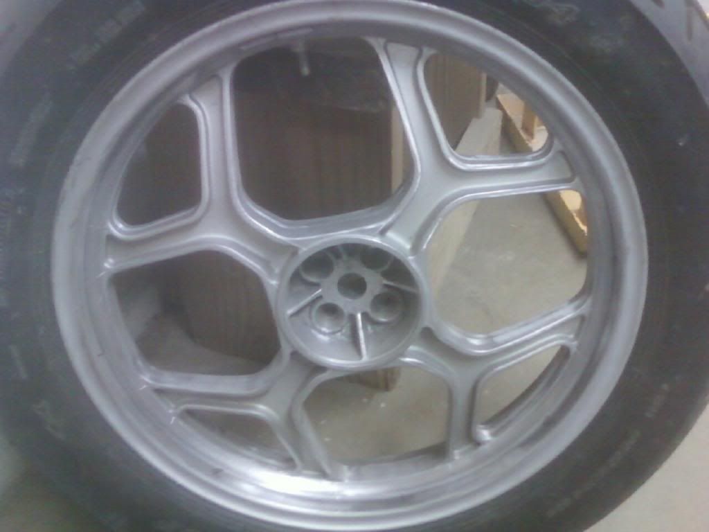

started smoothing the rear wheel for the sake of paint. parting line is mostly gone in this shot

heres another
