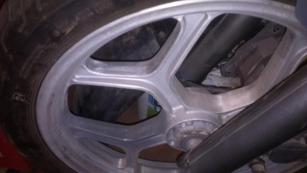

For me, the parting lines on the wheels bugged me more... Which is how this happened:
