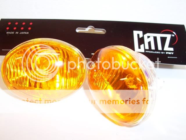

johnny: is your RS in this ebay ad? That's definitely my bike (or drake's)
http://www.ebay.com/itm/CATZ-FET-XLO-BMW-K1100-FOG-LIGHTS-ORANGE-K11OG-for-PIAA-/150498016039?hash=item230a617b27:m:mbGiFZ_TSVNa363TNh-NK_g&vxp=mtr
one of my XLO's burned out recently. I ordered a pair of bulbs from foglights.com...$53.70.
I was curious if anyone found some good and cheap LED's that are comparable to the XLO's but I figure I'd end up spending more and these bulbs seem to last a long time...worked fine for the 30k or so miles I've put on the bike and not sure how old they were to start with. I try to remember to turn them off when like sitting in traffic but I run them day and night.

this is the bugeye motobrick... aka bug 1...
i have 6 spares... the ones on the bug 2 came off the bug 1... combined they have nearly 150 thousand miles on them... i asked mr catz how long a bulb will last... he said 3 to 5 years on a car... i loaded up with spares...
have not had a failure... i thinks it cause they are on the light bar which is suspended... the fork mounted lights are subject to lotts of vibration and impact hits... yours is the first i know of failing...
also... they are designed to hang... so you have to remove the lens and turn it 180 degrees so the condensation hole is facing down... the 4 screws that hold the lens in there can be stubborn... id hit them with pb blaster... then warm them up... use the exact phillips screwdriver... or the unthinkable will happen...
this photo shows the amber ones hanging down they were good to go... the top blue ones are standing up... i had to turn the lens on the top ones 180 degrees... mr catz told me condensation would kill them faster than anything...

Jeff of foglights.com and the seller of these on ebay emailed me saying:
Quote
there are only 4-5 sets of the XLO's left in the USA. When they are gone, they are gone as FET in Japan does not even make these anymore. I have around 50 bulbs left though.
So you might want to get some before they're gone
