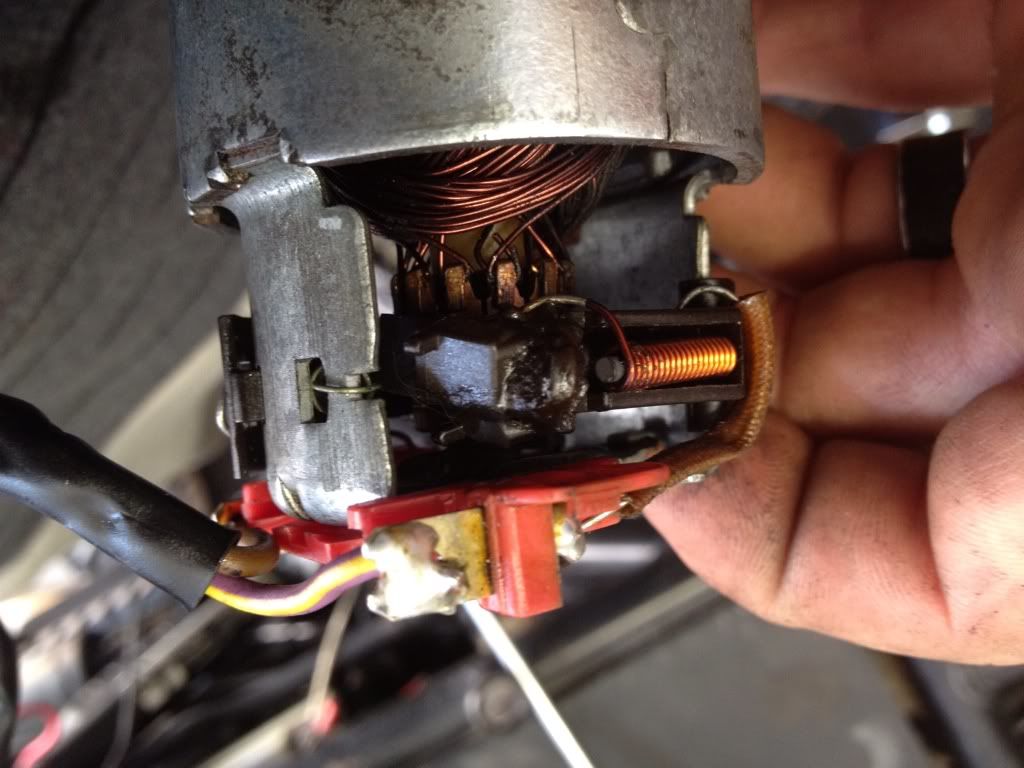

I was having an overheating problem and traced it to the radiator fan motor wiring harness
Good news is I found the problem, better news is the fan motor is still good. Bad news is that that actual magnetic slides that touch the copper cylinder is where the problem was.
Now if I can just track down the actual wiring harness part of the fan motor that would be excellent.

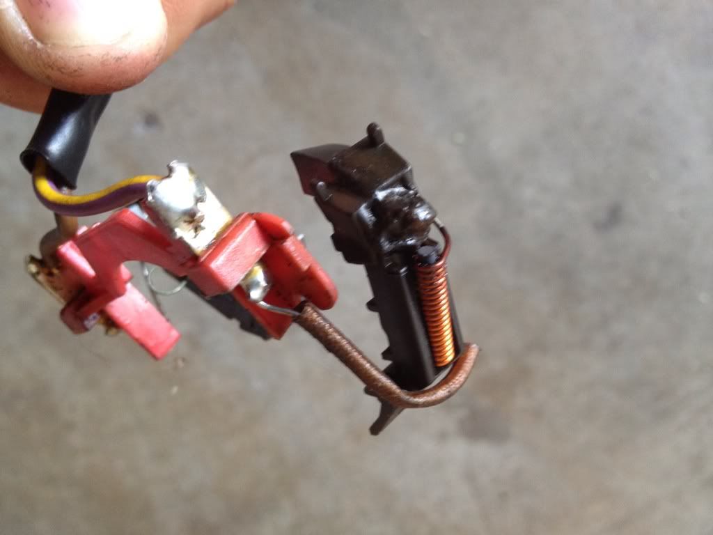

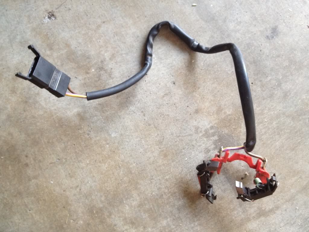

This is what I need. Just the harness. Not the whole motor
Actually, this is all I need. Just this one little dang piece. From the brown wire to the copper coil and plastic housing.
I would rather not have to spend $70 and get the whole fan assembly
Thanks for your help

I'm not sure if you can buy the harness as such. I'd just buy the fan motor from beemerboneyard or somewhere else who sells it.

The motor isn't very different from lots of other Bosch motors used for automotive ventilation fans or radiators. Even though the whole motor is fairly specfic to the brick's application the brush assembly may be common to various Bosch motors. You may want to check with an automotive motor shop, or if you have a good wrecking yard see if you can find a similar motor in a Volvo, VW, BMW, Mercedes, etc.

First question is what leads you to believe this part is the failing component?  Have you tested continuity from the soldering lug to the brush and found it to be open-circuit?
If so, have you thought about trying to remelt the solder on the lug?  Or maybe replace the wire from the lug to the brush?
Lots of questions but maybe trying to salvage the assembly you have may avoid having to purchase a new fan motor.
You might want to download the "Heat Management" document from the downloads page on K100rtforum.com as it contains instructions on replacing the BMW fan with a modern DC brushless fan (will give you longer term reliability).

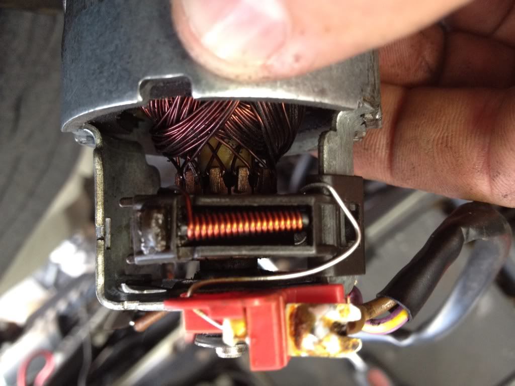

I apologize for my brief and somewhat vague description.  I did multiple tests with the fan and after careful examination I noticed the problem. The brush from the hot lead was severely melted, damaged, crooked, and in no way able to make contact with the actual motor. If you look closely at my second picture above (sorry its blurry) you can tell how disfigured the housing is from the meltdown.
Here is the good side. I noticed the silver clip and how centered the small copper coil and housing are.
Here is the bad side. No silver clip, I have no idea how that disappeared and how crooked and melted the housing is
Also the brush looked as if it was resting against the actual motor housing which would have caused the initial meltdown.
I may just go ahead and order the fan motor from beemer boneyard and have a spare. I really want to get back on the K75.
