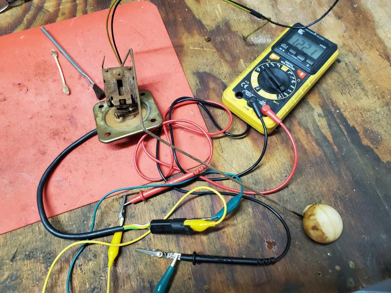

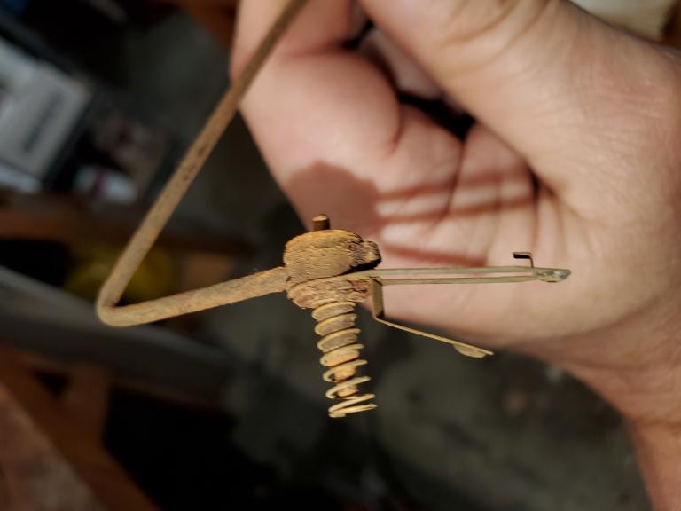

While I'm waiting on the folks in Idaho to resurrect my old fuel injectors and for my other parts order to be delivered, I figured I should revisit that crusty "fuel level" sending unit. I drained the tank and removed the old unit.
Like I said...pretty crusty. I also just learned that these pictures should be taken in landscape to orient properly when uploaded, too late now but you get the idea.
The rheostat was packed full of crud that I should have cleaned out prior to the initial installation, better late than never. I went to town with a small brush, swabs and contact cleaner (I've read a lot about Deoxit here, is it really worth the price premium over standard contact cleaner?). I got it as clean as I could before hooking up the multimeter.
* Resistance.jpg (92.78 kB . 768x576 - viewed 748 times)
The rheostat showed open for the entire sweep until it hit the bottom stop where it read about 122 ohms. If this was a real sending unit paired with an actual fuel level gauge then I'd be suspect, but this only operates a warning light so why there's even a rheostat is beyond me. I have no clue what the actual readout should be but it's not working like a proper potentiometer. In order to really clean this thing I'll have to take it apart, which involves bending four metal tabs that I hope don't break.
* 20241230_172226.jpg (30.27 kB . 768x576 - viewed 749 times)
Success, and not surprisingly I had a bit more cleaning to do.

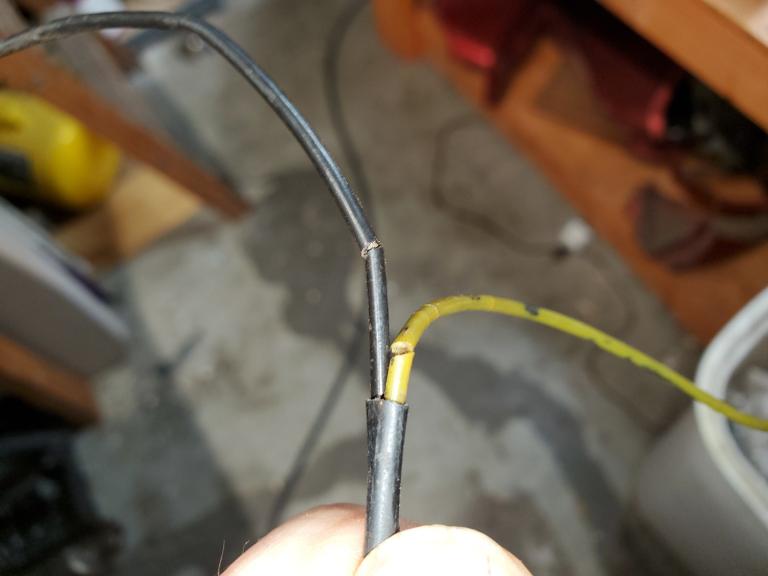

What is of bigger concern is the fuel pump wires, upon a closer examination the insulation is in pretty bad shape and cracks easily.
* Fuel Pump Wires.jpg (31.12 kB . 768x576 - viewed 729 times)
Of course this requires special wire meant to be submerged in fuel, so there's another part I'm waiting on. Par for the course on a project like this.

The reason for being able to measure the level is for when the optional extra fuel level gauge is chosen.
I don't like the kink in the hose, it's too much. Maybe it could be routed differently. It might get worse on a hot day. You can also get external coils to eliminate kinks.
