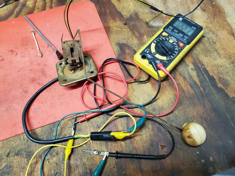

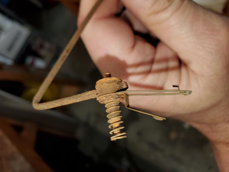

While I'm waiting on the folks in Idaho to resurrect my old fuel injectors and for my other parts order to be delivered, I figured I should revisit that crusty "fuel level" sending unit. I drained the tank and removed the old unit.
Like I said...pretty crusty. I also just learned that these pictures should be taken in landscape to orient properly when uploaded, too late now but you get the idea.
The rheostat was packed full of crud that I should have cleaned out prior to the initial installation, better late than never. I went to town with a small brush, swabs and contact cleaner (I've read a lot about Deoxit here, is it really worth the price premium over standard contact cleaner?). I got it as clean as I could before hooking up the multimeter.
* Resistance.jpg (92.78 kB . 768x576 - viewed 1653 times)
The rheostat showed open for the entire sweep until it hit the bottom stop where it read about 122 ohms. If this was a real sending unit paired with an actual fuel level gauge then I'd be suspect, but this only operates a warning light so why there's even a rheostat is beyond me. I have no clue what the actual readout should be but it's not working like a proper potentiometer. In order to really clean this thing I'll have to take it apart, which involves bending four metal tabs that I hope don't break.
* 20241230_172226.jpg (30.27 kB . 768x576 - viewed 1671 times)
Success, and not surprisingly I had a bit more cleaning to do.
Of course being a BMW it isn't wired like a typical rheostat either, this uses an unusual (to me) dual-wiper design that slides across both the wire coil and an adjacent metal plate, completing the circuit between the two and creating the variable resistance. The plate indicated open to both wires which isn't good, and the only way to get back there was to remove the phenolic plate with the wire coil. That's when I decided I can live without a low-fuel light for awhile, it's easy enough to get to this part as long as the tank is empty so this concern will get shelved for now.

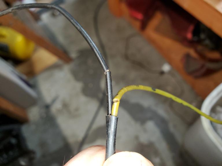

What is of bigger concern is the fuel pump wires, upon a closer examination the insulation is in pretty bad shape and cracks easily.
* Fuel Pump Wires.jpg (31.12 kB . 768x576 - viewed 1591 times)
Of course this requires special wire meant to be submerged in fuel, so there's another part I'm waiting on. Par for the course on a project like this.
