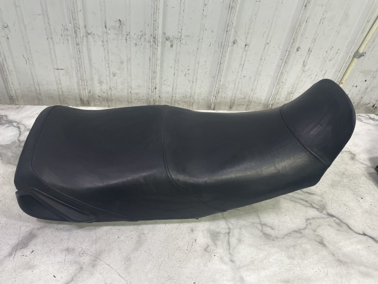

one more honorable mention concerning the '85 FYK (Finest Year K)
The seat is specific to the '85. Seat pan has the molded handles. 1986 & onward the molded handles are part of the rear tail cowling.
Caveat: If the rear tail cowling is upgraded to newer type then the newer version of the seat will be installed
'85 Seat with molded handles
OE Fehrer Newer version seat, sans handles
