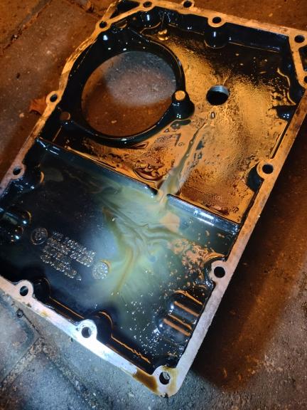

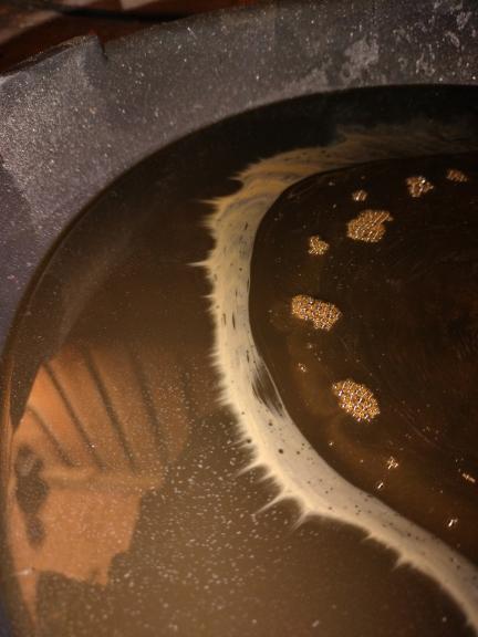

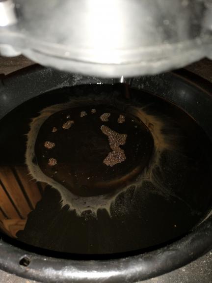

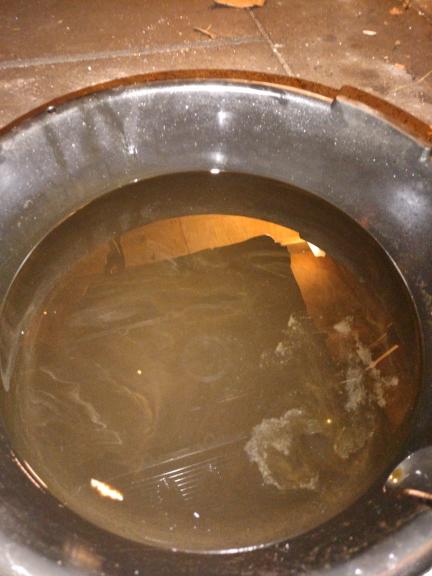

Streaks of yellow appearing in my sight glass on my last few rides in October before winter storage (Denmark it is 3 months, december-april), i decided to now drain the oil, and have a look at where the water could be coming from. As you can see in the attached picture, the water amount isn't crazy (there is picture of first drain and second drain where it drained for 2 days), but it has me worrying if i have an internal coolant leak/crack.

Could this just be condensation from the last few trips? (They weren't long) or being stored for 3 months? Or am I looking at a serious problem?

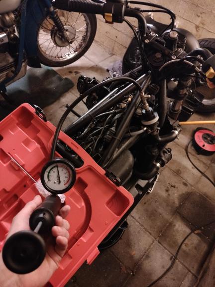

Coolant system pressure test @16 psi for 6 seconds and 15psi for 1h +, no apparent loss of pressure, and no leaking coolant when I view the block from below with oil pan removed.

You could do a crude test to see if it is coolant or water that is contaminating your oil.
Take a sample of oil with the emulsion in it and heat it slowly to above 100C.  You will smell the oil vapor and if there is water not much else.  If there is coolant the vapor given off at high temperature will be very acrid.
To get an idea of what it smells like take a small amount of coolant(2cc) and heat it by itself.  The odor is very distinctive.

I'm still alive, the wife didnt kill me, just forced me to buy a new pot. It wasn't coolant, only water in the oil, didn't smell at all (except our whole house still reeks of engine oil).
Today I was removing the timing chain cover to fix a small oil leak, and immediately as i started prying it off, clean water poured out the bottom, small puddles upwards coming from underneath the small vent/tube on the top!
The vent is not secured properly, has no gasket, and water can easily leak down around the tube during rain/washing and into the engine.
Ill be taking it off and putting some liquid sealant on it to keep out water.
I am so glad it turned out to be something so stupid 112350
