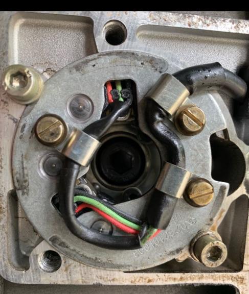

Hello, after a year of running, the original problem seems solved.
After lots of testings, I decided to buy a new HALL sensor.
After disconnecting the old one from the harness, I cleaned the harness connector with dioxit 5, just in case.
The crazy thing, is that the hall has the advance out of standard position
here a picture.
* hall sensor.jpeg (50.38 kB . 487x576 - viewed 732 times)
So I installed the new, in the correct position.
I was amazed, how different the ride was!
the bike gains lot of power and reaction.
is crazy because I drove it for 12 years, with the engine muffled, now the bike is more alive than ever, and it has lower consumption.
All in all, it was the Hall sensor.
After that, not more hesitation during hot days, engine keeps alive.
I want to thanks all the members that helps me to understand the problem.

« Reply #36 on: September 19, 2023, 10:27:43 AM »
The crazy thing, is that the hall has the advance out of standard position.
It's likely that the old sensor still functions, so now you have a spare, maybe.  icon_cheers

Hi Laitch, yes, I’ll keep the old one as a spare.
One strange thing happens in all this situation.
When I decided to replace the sensor, I realize that the sensor connection to the harness was hide under the frame. So this was the only connection that I didn’t clean with deoxit5 when I overhaul the bike…...may be cleaning it solved the problem? I don’t know.
Now as you said, I’ll keep the used sensor, and even I’ll bring it if I do a long travel….
Thanks Laitch!
