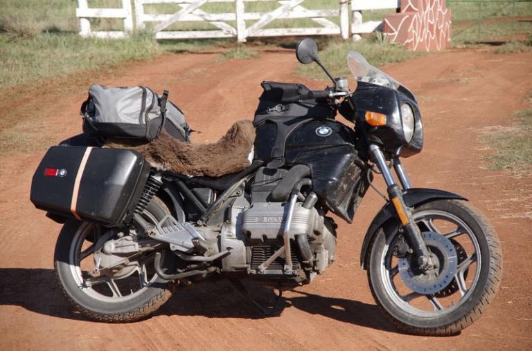

Hello all, long time without posting.
Ok, i want to wake up my K75C 86, after 6 years.
She has been inside, it's clean.
Ok, problems known, are:
Starter Relay: last time used, bad battery, so it sticked, it has been dismantled, sanded and ready to use,
Battery: dead
That's it, since 2015
My plan after buy a new battery is:
1: clean and absorbs fuel ( HOW?) inside the fuel tank.
2: change filter and fuel lines inside the tank
3: Empty refrigeration system, clean ( with what? how?) cooler container ( i remember the mayonaise thing...)
4: clean spark plugs
5 : add fuel, cross the fingers and fire up.
I'm forgetting something?
Is my way to go, ok?
Any tip will be reaaly apreciated, as i love this bike a lot.
Thanks all!!
