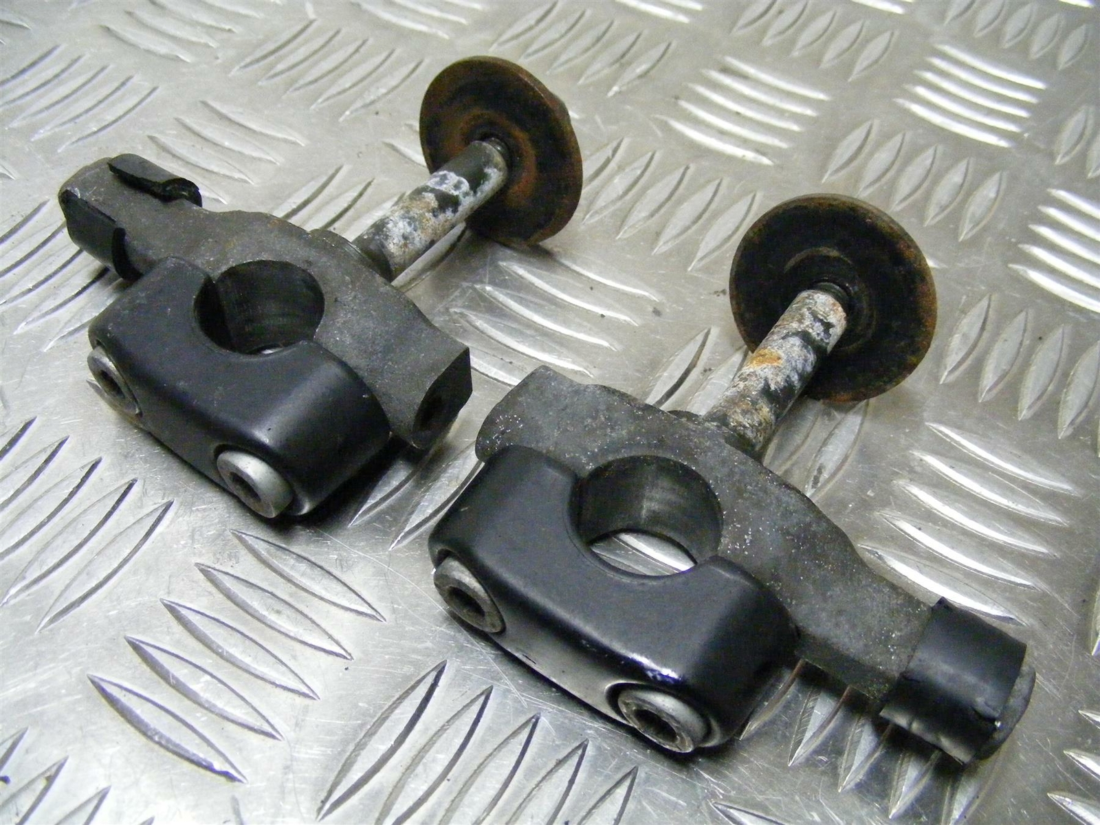

Next question, the handlebars seem to have a lot of movement, I see one of the rubbers is ripped.....but is this movement normal?

. . . the handlebars seem to have a lot of movement, I see one of the rubbers is ripped.....but is this movement normal?
It could be normal for a handlebar with one of its suspension cushions ripped, especially if the rip is from the perimeter inward.
I can't seem to find the part at all on Max BMW, can you see it? If so, please post the part number. I would like to replace them before I put it back together. Thanks!

I think I found it, called a "hose"
Here is the part from an auction:
Looks like it is round:
Part Number 32 71 2 307 356

« Reply #66 on: May 13, 2020, 10:28:29 AM »
i takes those suspension cushions out and putts warshers in there for a ridgid mount and firmer bar...
Johnny-
Having a hard time thinking of how I put in washers, maybe take the plate off, then put the washers around the square shaft and then the plate back on so it sandwiches the washers?

I think I found it, called a "hose"Part Number 32 71 2 307 356
That looks like it might act as a bumper to provide tension on the dash. The looseness might also be caused by the suspension cushions, which johnny might be indicating could be removed entirely then replaced with washers. What is the condition of the suspension cushions?

Johnny-
Looks like you could use large washers with small holes , so they fit outside , not in.
