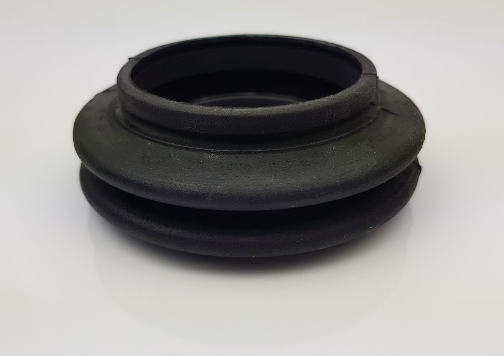

Another thing, I noticed that Laitch posted a drawing of a Paralever.  According to PmP's signature, he has a K75 which would be a Monolever and thus has no gaiter and a different assembly procedure.
Re: Kopr Kote On Drivetrain
« Reply #40 on: September 11, 2021, 11:29:16 AM »
Both 2V and 4V Ks have the exact same gaiter (part 33171454552) where the front of the swing arm meets the transmission.
. . . which I can confirm as everything is in about a million pieces all over the place. Which gets me to the fact that I have a 22 mm and a 30 mm socket (and all the sizes below 22) but NO 27 mm socket! Which makes torquing the counter-bolt on the swing arm interesting.
