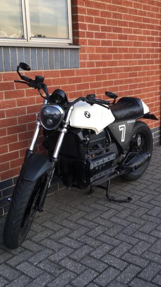

« Reply #108 on: May 22, 2019, 06:47:37 AM »
Morning folks
Been a long time since I posted here. Bikes still going well but I have a list of things I need to attend to.
1)  Sort out the air balance. Still runs rich. The plugs need regular cleaning.
2)  The Fan is not coming on. Possibly its not getting hot enough but I suspect either the relay or sensor.
3)  Bloody Starter motor. Had to jump start it a few times. Just found out about the reverse sprag thing. But its working again at the moment.
4)  Fuel light, Not really important as I have a working gauge.
Still looks good though

« Reply #109 on: June 01, 2019, 05:24:49 AM »
Morning folks
* file-44.jpeg (37.82 kB . 324x576 - viewed 1401 times)
Had some time yesterday.
Carried out a throttle body Balance using a set of vacuum gauges. And then tried the lean drop method to try to clean the CO2 mix. Seems to be running much smoother and cleaner. The adjusted is a fiddly little sucker to get to with my oversized mitts. It was really out a long way so I expect it to be better. I will run it for a while and chack for further soot.
Tried the reverse sprag cleaning thing a few times and it starts fine. I'm not actually sure if it isn't battery/alternator related as when it stopped working I lost the indicators lights and horn. I always leave my bikes on trickle chargers so it's always OK when I first start and leave but tends to fail later. Further investigation to follow.

* C7425809-7F5C-44AE-B402-DC08D0CF0F54.jpeg (23.51 kB . 240x320 - viewed 917 times)
* A028C86D-5BC6-4B34-ADA8-D0C178345FA2.jpeg (23.88 kB . 240x320 - viewed 877 times)

Elegant.
Offline Skunky
  • Posts: 527
Re: Not a cafe racer project K100
« Reply #124 on: March 01, 2020, 06:02:36 PM »
Elegant.
Thanks Billday. I'm pleased with how its shaping up. More time on it tomorrow.
