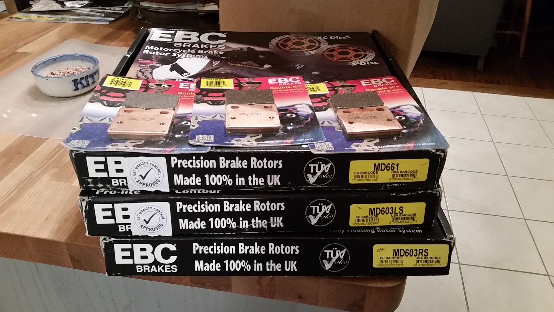

« Reply #13 on: February 24, 2017, 08:31:10 PM »
Really? That would work? That would be fantastic, both my fronts are at 5 mm and the rear even less.  The three together from EBC via Amazon are over $600  :dunno

« Reply #17 on: February 25, 2017, 10:11:31 AM »
Yeah with EBC they specify whether it is ABS or not, I knew the ring doesn't come with the ABS one but had assumed a non ABS one doesn't have the holes to mount the ring or was in some other way different.
