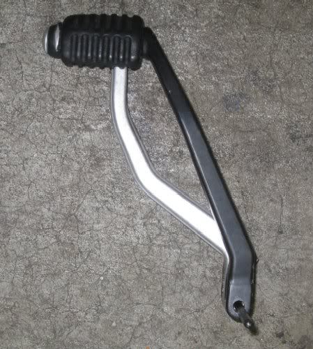

« Reply #13 on: May 30, 2011, 03:23:31 PM »
You could also try installing a shift lever from a K1100.  That has about 1/2" more toe clearance.
Hmmm, it looks like you overlaid the K75 lever on top of K1100. Aside from the shape of the K1100 arm being different, they look like the same distance from the output shaft hole to rubber covering. So it seems like the difference is the footpeg is probably a half inch further back on the 1100.

Yes, a K1100 trans will bolt right up to a K75.  The only difference is that the K1100 trans has a slightly taller 5th gear - 1.67 vs. the 1.61 of a K75.  You can't go the other way though because the K75 doesn't have the mounting tangs with a hole for the mounting paralever strut.
The K1100 shift lever does have a bit more toe clearance.  It's shaped a bit differently in order to clear the heat shield over the header collector.

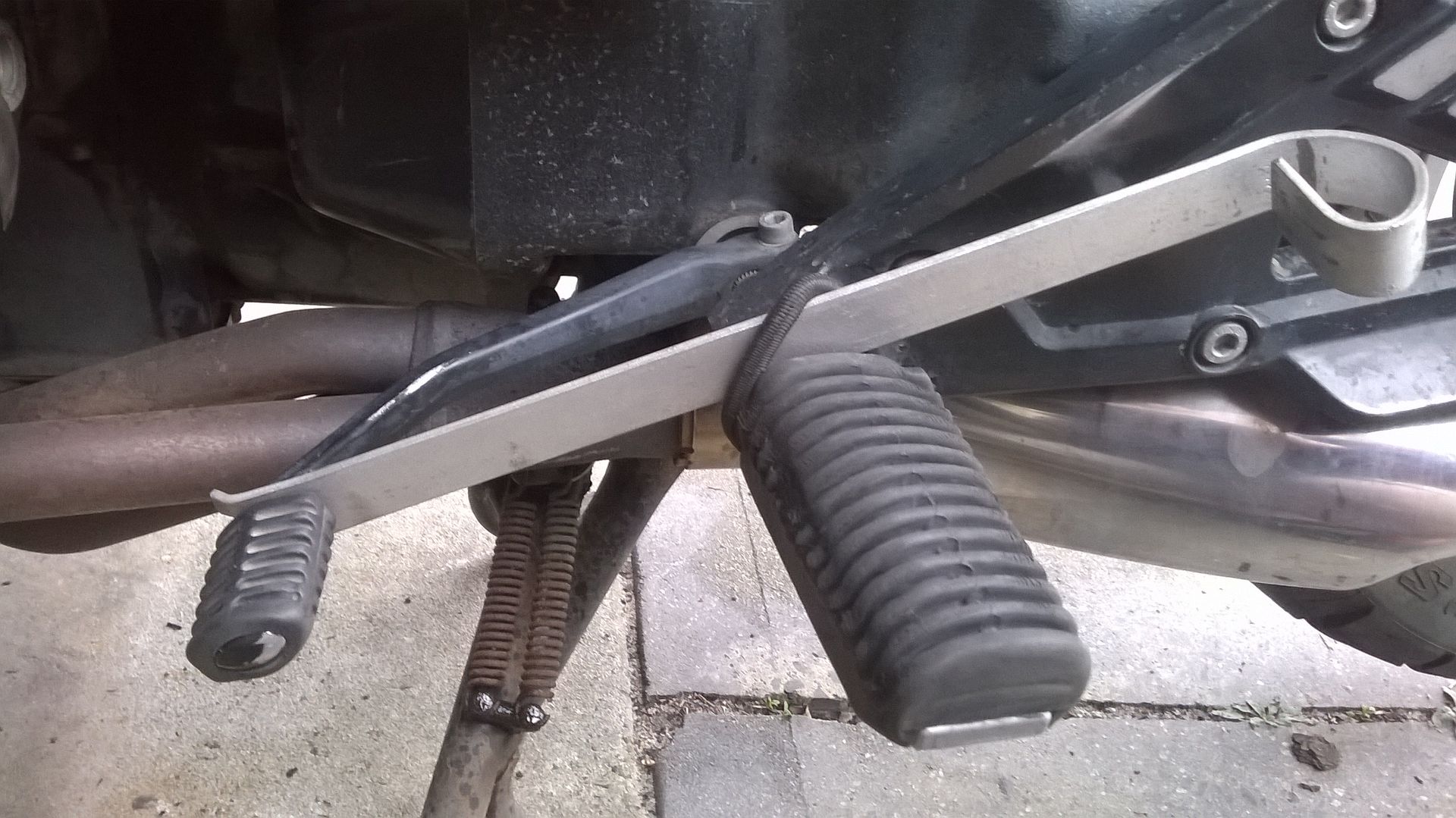

« Reply #22 on: August 29, 2016, 06:09:54 PM »
OK - here's a heel-toe shift I've now fashioned from a simple piece of gavanized steel, rigged and tested on my K75:
It's held in place on the regular gear shift by the rubber pad, and by the small bend you can see at the tip that prevents it sliding backwards. A small loop of black bungee cord holds it in place at the inboard edge of the footpeg. It works well, and is straight-forward to install.
