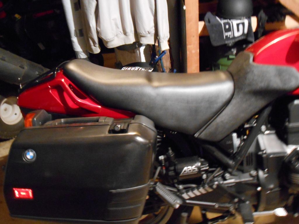

My '95 K75 has a low profile seat, which seems to be the "standard" seat for BMW, even the brand new ones.  I took my seat to an auto uphostery shop and had about 3" of foam added into the low profile dip and another inch in the driver saddle area then a new cover installed at a very reasonable price--a bunch less than a new seat.
Would you please post a profile view photo of your modified seat, White Dog?

Click on this link.  http://<a href="http://s105.photobucket.com/user/WhiteDog14/media/DSCN6218_zps2igcsieg.jpg.html" target="_blank"><img src="http://i105.photobucket.com/albums/m218/WhiteDog14/DSCN6218_zps2igcsieg.jpg" border="0" alt=" photo DSCN6218_zps2igcsieg.jpg"/>[/url]

Click on this link.
Thanks, White Dog. That's an attractive low seat modification. What's the seat height measured from the floor?

I really needed 3 hands to steady the bike and measure, but mine is roughly 32" from middle of driver seat to floor.  A good uphosterer could probably add foam and reuse your existing cover.  Mine had several tears in it so I had it replaced.  "Do you want fries with that?"
:giggles Sure—with plenty of salt, too.
Phil Hawksley's site lists the high seat at 31.9 and the low at 29.9. You've built that seat up to the high seat measurement. Somebody's bound to benefit from the information and photos you've posted here.  Thanks for the info.

Well, I'm sure I could have found a high seat in a junkyard but as rare as K75 cycles seem to be, I would have probably had to pay more than having mine modified by a trusted, one man shop.
