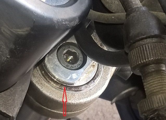

Oil seems to be coming out of this part (indicated by the red arrow) - It seems to be loose as in it turns easily with a spanner. Is this the plug as described above? Is it supposed to turn or should it be tight? I haven't been able to check the center cap screw as I need to unbolt the bars to get at it.
If it is the O rings, are they are standard size (that I could find in my O ring kit) or are they an "order from BMW" part?
If I remove the plug as described in Martins post, does the top come out under pressure or just a little spring load? I debated doing the fork seals myself last time but not understanding how they are constructed I thought it best to subbie that job out.

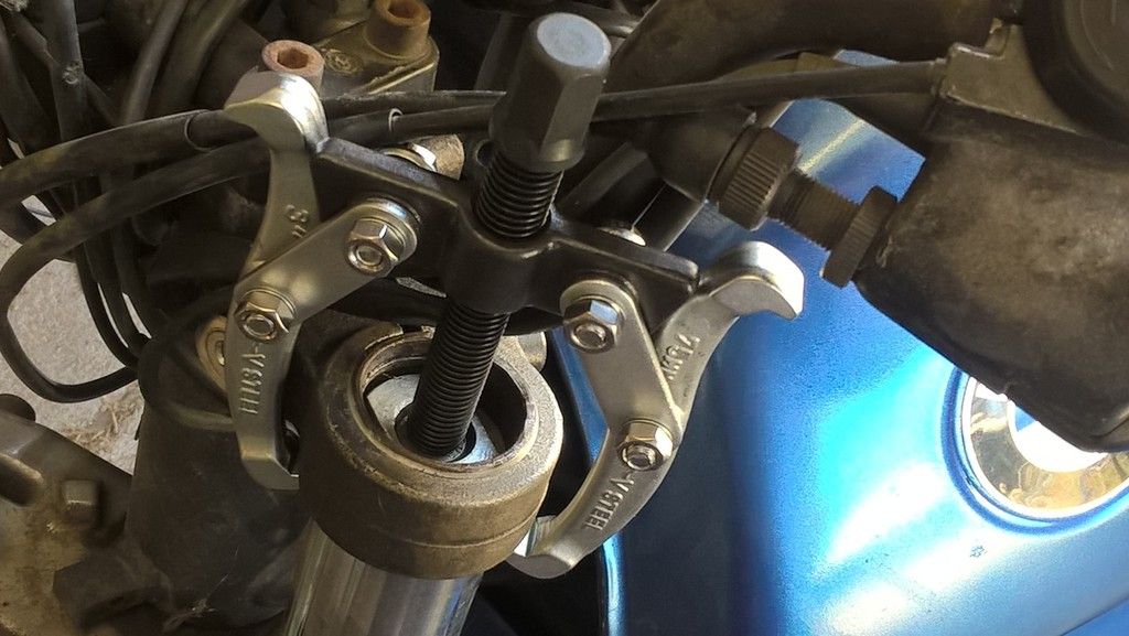

George it's the "O" rings around the top plug that you need to replace. You might have the right size in your kit, it's not hard to remove the plug and size up with the one's in your kit. You can rotate the plug's with a spanner, they're only held in with a circlip. You can reduce the amount of pressure by putting a block of wood between the front of the engine and a jack, and jack up until front wheel is off the ground and the rear is now on the ground. Remove the belly pan first you don't want to damage it ,you shouldn't have on on a 75c.The amount of pressure generated by the spring is easily managed. If you don't want to do it by hand Supercheap has a small three legged puller that will compress the spring while you remove the circlip.

I may have a chop at this this afternoon - I already have the 3 legged puller, I was just concerned about the pressures. Having changed springs in cars and 4wds I have a very healthy respect for the stored energy kept within them.

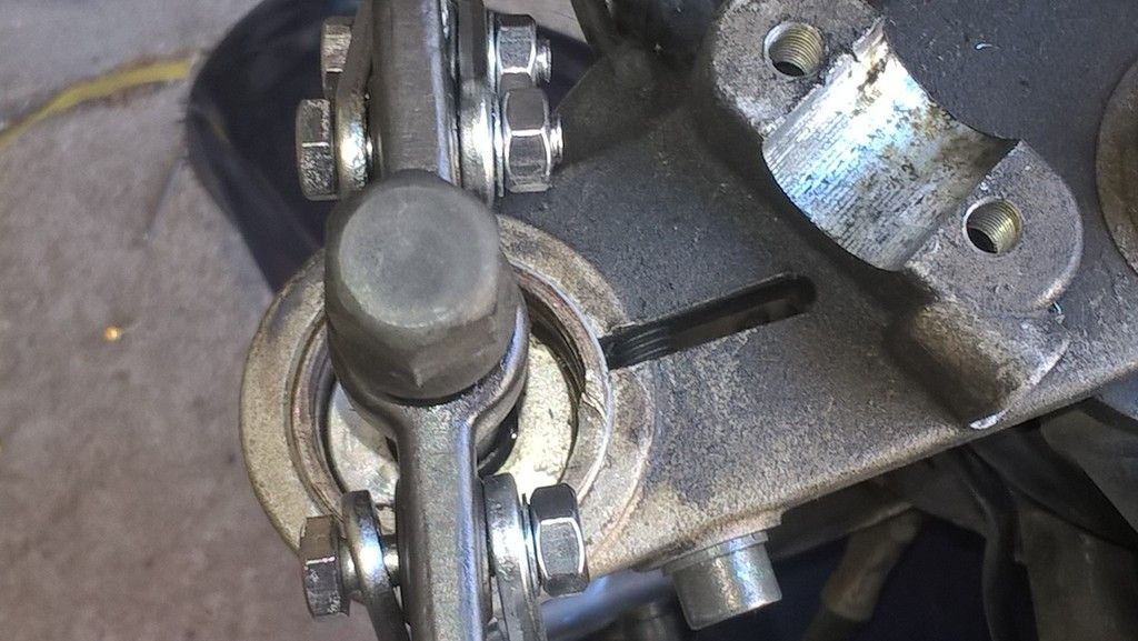

Had trouble with this particular one as someone had flogged the top of the fork tube and burred it over as pictured. I compressed the plug further down the tube and used a die grinder on a Dremmel to grind away the burr, then flushed out the filings with some WD40 and compressed air.
I found the correct O rings in a standard O ring kit and reinstalled using the puller and a little rubber grease to help it slide in.
