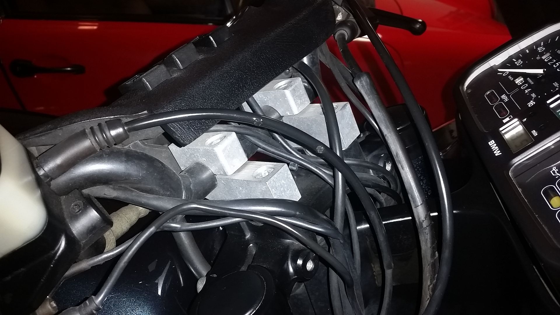

the K75s i bought came with barbacks installed.
i would like to remove them and put the s handlebar in the stock location.
the PO did not have the stock upper parts of the handlebar mounts and bolts.
if i pull the barbacks, can i use the upper part of the barback mount in place of the stock part?
thanks!

On mine, the upper part of the barbacks is the stock part. You should just need the shorter bolts.

thanks Y'all. i stared at it and figured it should work, but did want to invest that whole hour (including coffee, donuts, reading motobrick, moving wires, etc) only to find out the upper part of the mount did not fit in stock location for some reason...or the bolts would not work.....
upper part of mount does not look like stock part.

you might not even need shorter bolts. The front ones are fine, loose the middle long ones and the back ones should be short. I think mine just came with the spacer hunks of aluminum and the 2 longer bolts, but that was many decades and brain cells ago.

didn't need the MRI thankfully. the barback "top" piece worked in place of the stock "top" piece. back to stock.
