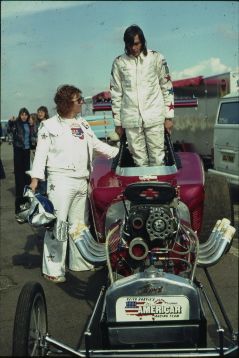

As to the Comp Altered [ 2 actually ] - the first was a Chevy 454ci blown injected altered running on Methanol. This was in the early 70's when 8mm leads were "the business".
The last one was a 502ci Ford with 3 stage Nitrous Oxide assist. Initially fitted with 8mm leads, but they couldn't cope when the 2nd and 3rd stage Nitrous was operated. So, it was dig deep in the pockets for some 10MM versions - which did the job.
The First Comp Altered in Custom Car 1974 [?]
