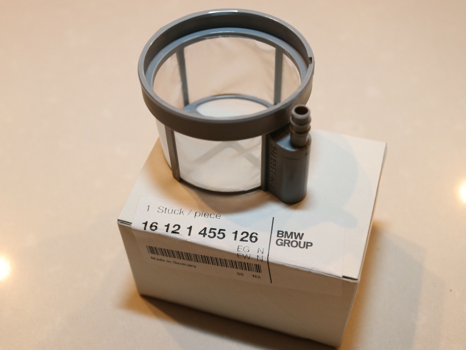

With the later model tank that uses the 43mm pump, they not only changed the basket to a sock, they also re-designed the fuel return and just let it dump wild in the tank.(hence a later 1994 TSB 16 018 94 to connect a hose from the return line open end and run the hose to the left side of the tank by the fuel pump.) Like you mention to prevent cavitation and pump noise by returning the fuel as close to the pump as possible.

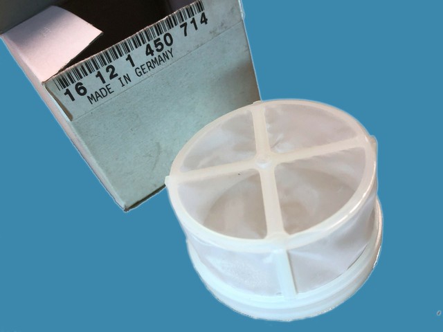

I noticed an error on that page. It says for the 85 and earlier tanks "No provision for a screen on the fuel pump."  That's not true. Those bikes did have a fuel pump screen.  But it differed from the later screens in that it did not have a connection for the anti-cav hose.
85 and earlier screen: Part 16121450714
86 and later 52mm fuel pump screen: Part 16121455126
It doesn't say the tanks had no screens; it indicates there was no provision for screens which could possibly mean ridges, tabs, stops or something else besides the tank floor to position the screen. Regardless, if there were no screens at the beginning of production, it's likely BMW started supplying screens as soon reports of pump cavitation started hitting the decks.  :laughing4-giggles:
You could possibly have a valuable oem sample there, duck, worth even more with its original box and extra special if it were autographed by Michel, Gevert or Probst, if what Wikipedia tells us it accurate..  icon_cheers  Get admission to Antiques Roadshow when it's in your neighborhood and have it evaluated.
The pump intake was squatting right down on the bottom of the filter. Odd but true. I repositioned it and that was that, as my story goes.
Every 85 I've ever dealt with had a fuel pump screen.  And it's there for more than just anti-cavitation.  It's also there to keep crap out of the fuel pump since the fuel filter isn't in the system until after the fuel pump.
The used to be NA but now Max BMW shows them as available aqain.
