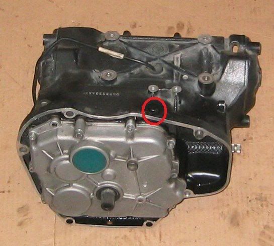

Btw. I put a crush washer on that drainplug, guessing there's supposed to be one there? There was only a somewhat conical washer there, fixed to the plug.

You removed the "conical washer", right? That's the old crush washer.

« Reply #8 on: September 01, 2013, 02:02:03 PM »
I didn't remove it because it was much too narrow to pass over the threads. You can see it in the picture if you enlarge it. If that's the old crush washer, it's extremely deformed, so I thought it was supposed to be there... but it isn't?

« Reply #10 on: September 01, 2013, 02:05:22 PM »
If you can drain, save and re-use the trans fluid you just put in, I suggest you remove that ancient washer (and ideally the new one too) and put it all back together with a new washer.
It's possible that you won't have a leaking problem if you leave things as-is, but...
You'll find that the old washer can be pried off without too much trouble.
Ok, thanks for the info, I'll see if I can get it removed sometime.
