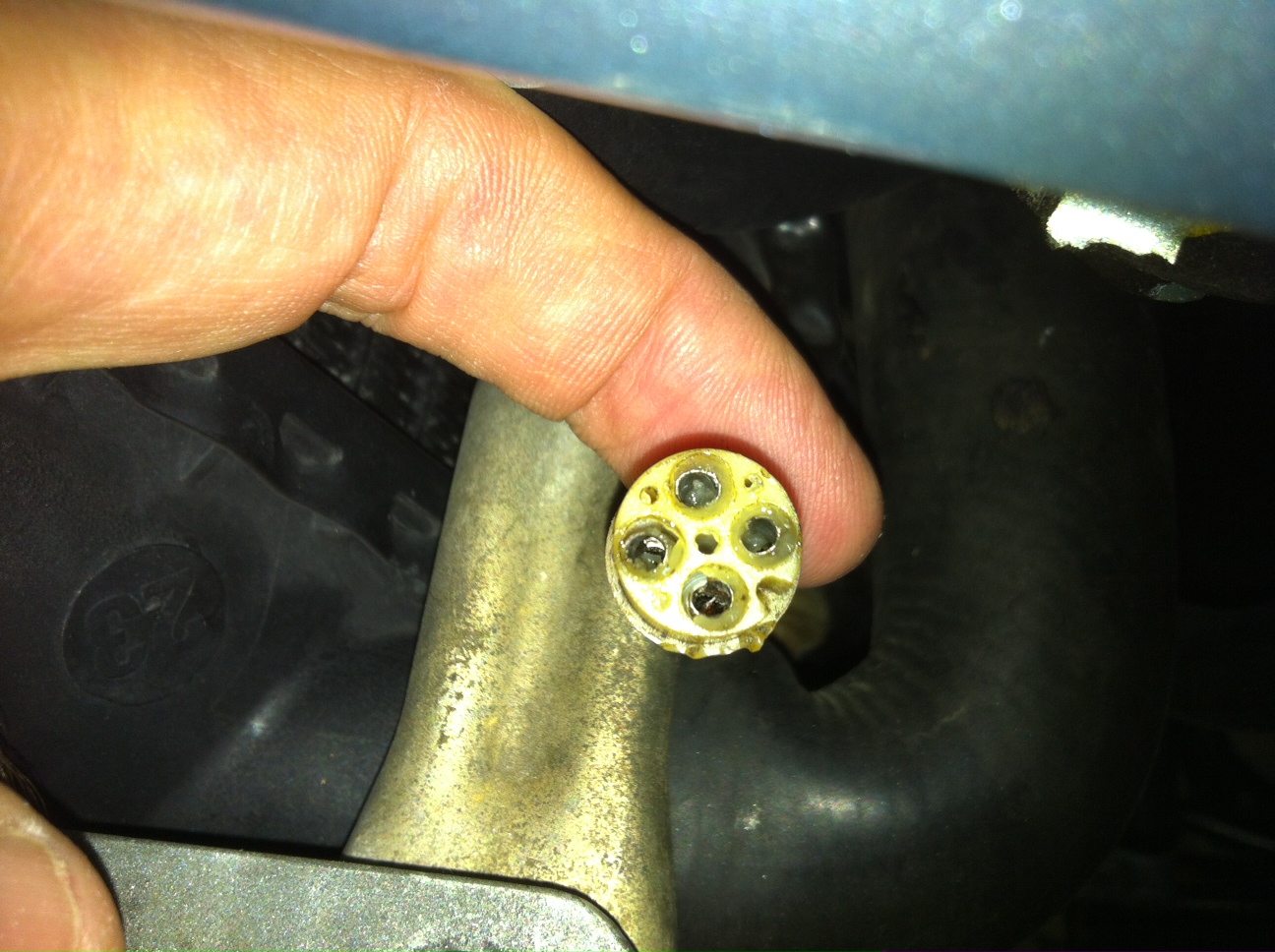

« Reply #18 on: February 05, 2012, 12:17:38 PM »
Here's a picture to clear it up.  This is the only electrical connection to the fuel tank, and I understand that it provides power to the fuel pump, and picks up the signal from the level sender inside the tank.  If you look closely you can see what I mean about the splayed connector pin inside. I think the ones at 9 O'clock and 12:00 are getting about 50-75% contact. That's dielectric grease all around the pins.
My fuel level indicator is actually pretty reliable and when it comes on I need around 3.5 gals of fuel. Usually between 120-140 miles since last fillup. Probably works better than most K100's from what I hear.
So I was wondering if I can just buy a new connector like this, or maybe remove the pins and replace them, or repurpose a similar connector on the bike.   I do not think the mating half of this connection is the issue.
I am a bit concerned about the other comment that maybe this is the early signs of a fuel pump failure. But based on the looks of the connection I would like to eliminate that option first as it would seem cheapest.

Offline Inge K.
  • Posts: 1451
Re: Intermittent fuel cutoff and then full recovery-baffled
« Reply #20 on: February 05, 2012, 12:56:54 PM »
The connector shown in your picture is used on the -83-85 year models.
The suggestions with trailer connectors is valid to -86 on models.
(which have piece of wire between the tank and the connector).
Maybe you could fit some thin pieces of plastic sheet (or whatever) between
the single terminals and the connector housing, and that way getting better
tension on the female terminals?
Inge K.

Aha. Now I understand. Thanks for pointing that out! I couldn't figure out how a trailer connector would help in my situation. We were comparing apples and oranges.  The 85 K100RS has a lot of unique bits and pieces.
I like the idea of putting some sort of insulating material like plastic inside the gap.  Or maybe I could fill the female pin with grease and pour some epoxy around the outside. The grease would keep epoxy out of the pin hollow and then the male  pin would just push the grease out the bottom after the epoxy sets.  Might be a good workaround if I cant find a replacement connector.
Of course I took the bike out for a 150 mile ride and it didn't show any symptoms. Possibly that was because I removed the connector to take the picture and reseated it again before the ride. SO I think I'm getting close to root cause.

Offline Inge K.
  • Posts: 1451
« Reply #22 on: February 05, 2012, 05:40:49 PM »
If you use some thin sheet of plastic (or similar), and it don`t turn out as expected the first
time...you can pick it out and replace it with something that is a hair thicker.
If you fill the area between with epoxy......you`re kind of stuck.
Inge K.

Offline BrickFlyer
  • Posts: 106
« Reply #23 on: February 05, 2012, 06:02:18 PM »
Good point. I will try the shimming method first.  :2thumbup:
