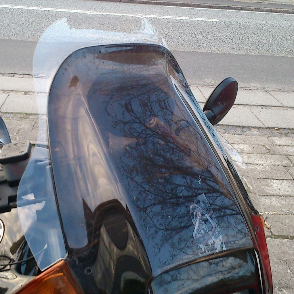

This windscreen that I recently bought from Motor Works, UK for my '88 K75S
http://www.motorworks.co.uk/vlive/Shop/Parts.php?T=5&NU=15&M=40&Ct=VA&SbCt=BA_15_40_VA_40
works for me. It's about three inches taller than the original screen and the wind buffeting on my chest and helmet is far less pronounced. The bug season hasn't really started in Northern Europe yet, but so far my helmet visor is absolutely clean while the screen has squashed a couple of bugs. The air is deflected over the top of my helmet. I'm about 178 cm tall.
The small "winglets" protruding above the flashers do a good job of deflecting the air from the handlebars. I have not done any riding in the rain yet, but I'm sure that my gloves will stay dry for much longer, even in a downpour.
My only regret is that I was too impatient to wait till Motor Works had the tinted version back in stock.
Just a little taller and wider than the original.

That Motor Works screen looks really nice.
Looks like it's cut to avoid interference with the mirrors?
It looks to be an inch or two taller than the stock screen with the Laminar Lip would be.
