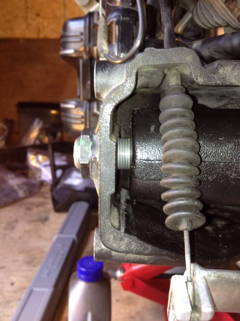

Here's a photo of the left pivot torqued properly, does this gap look right to you guys?

The space between the swingarm and gearbox housing seems kind of normal to me.
(never counted the number of visible threads, when this work been done..............using my toothbrush which fits perfect for cleaning the threads and by judging the picture it seems be correct width to fit...................it`s one bird two stones with this....I smoke a whole lot...and get a good abrasive effect on my toothbrush, removes nicotine very good  :loopy:)
Since you asked about the tighning sequence in a earlier post.
1. Thighten the RHS fixed pivot to the correct torque.
2. Thighten the LHS adjustable pivot to the correct torque, to get the correct preload on the bearings.
3. Thighten the nut, while holding the adjustable pivot stationary.
Inge K.

  • Posts: 244
  • Last of the True Southern Sweet Mullets and Squids
Is that pin centered and seated properly?
« Reply #9 on: July 12, 2012, 08:23:11 AM »
Maybe it's an optical dillusion but in that photo it looks like the pin is not centered on the end of the swingarm.
Ridin' 87 K75S vin 1334,
Renchin' 86 75S vin 0061
Offline tsbt
  • Posts: 241
Re: Is that pin centered and seated properly?
« Reply #10 on: July 12, 2012, 09:42:34 AM »
iphone photo trickery and whichcraft :yes wide angle lens on there, pretty good in most cases just not accurate ones.
