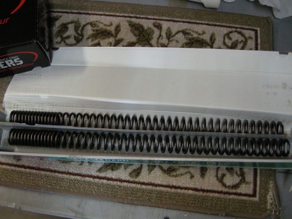

I recently purchased a pair of Wilbers Promoto front fork springs. I want to install these but there is very little information in either the BMW shop manual, Haynes or Clymer.
Does anyone have any experience with this type job? Would you be willing to share some pointers? With reference to the microfiche picture below, if I replace the old OEM compression spring (part #8, I presume), am I looking at what amounts to the equivalent job of changing the fork oil with a swapping of compression fork springs? What about the spacer tubes, will that remain or will I end discarding?
