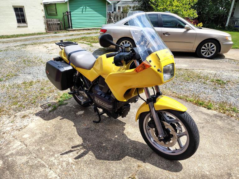

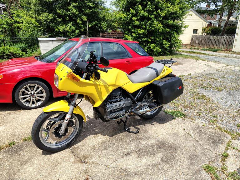

Recently I had the brilliant idea to put the bike in quite a few pieces to replace the radiator fan as I noticed the bike had started to overheat on the parking lot that is I95 through Virginia. While I had the bike apart I had made the decision to do a few other things at the same time, I decided she deserved some new paint and new parts so I had the bike painted yellow close-ish to the 1994 Dakar yellow by a local paint shop. I changed the air filter, fuel filter, coolant, replaced my ripped/torn crank case bleeder hose and the fuel return line to the tank, my definitely warped front brake rotors and lastly my fuel injectors.
After reassembling the bike to a running state I kicked her on and she didn't wanna start at half choke from cold, which isn't that unusual for my bike so I kicked it to max and cranked it and it started right up, so I did what anybody does I revved the bike a bit and she sputtered so I revved it fully and it died. Bike would still rev and it got better when it warmed up but it was a noticeable lag on the throttle and it definitely didn't seem happy to rev. At this point, rather stupidly I reassembled the entire motorcycle because I am a fool. I think my logic was its probably just the injectors and I can get to those without the bike being completely apart.
* IMG_20260509_131913359_HDR.jpg (131.35 kB . 768x576 - viewed 575 times)
* IMG_20260509_131859900_HDR.jpg (141.72 kB . 768x576 - viewed 551 times)
Pretty happy with the look though.

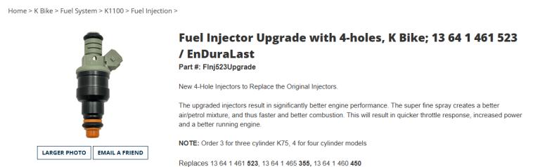

At this point I started trouble shooting stuff found it to be running lean using the starter button test. I figured I had a vacuum leak. So I checked with some qd electric cleaner and somehow found nothing, still don't know how. Eventually I decided to replace the fuel injector O rings as they just didn't look the same size as the old ones when I compared them (I'm probably tweaking). After this I was some how no longer getting the rev increase while holding the starter, but the bike still was stalling when cold and still had a noticible lag when giving it heavy throttle, it was also still lacking power, but it was at least ridable once warm, albeit with a bunch of lag and a lot less power and the silent unnerving voice in my ear whispering that I'm breaking the bike by riding right now and I'm going to kill my baby.
Injectors in Question were the Upgraded ones from Euromotolectrics - https://www.euromotoelectrics.com/product-p/finj523upgrade.htm

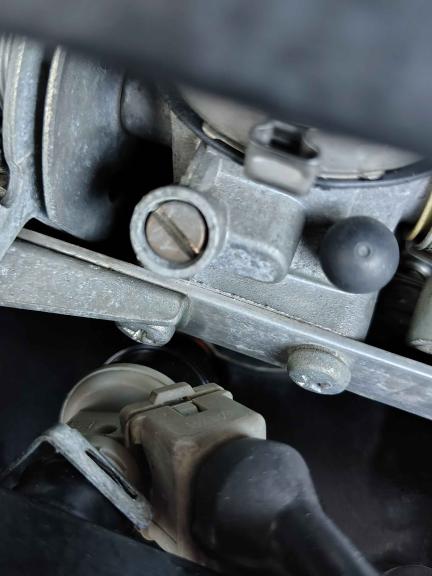

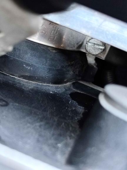

After carefully reinstalling all the injectors  again in an effort to fix the lag the bike had the same problem but after going to an autozone on the bike I bought some starter fluid and this time I found a vacuum leak around I THINK the middle intake manifold. Part number 1 on this page
https://www.realoem.com/bmw/enUS/showparts?id=0572-USA-01-1990-K569-BMW-K_75_S_0563,0572_&diagId=11_1776
* TheCulprit1.jpg (30.73 kB . 432x576 - viewed 513 times)
* Culprit 2.jpg (26.45 kB . 432x576 - viewed 522 times)
* Intake Manifold.png (8.05 kB . 94x61 - viewed 530 times)
The Culprit, I hope
I'm posting for one because I just cant tell if its cracked I know usually you have to remove it for these parts to tell but also I cant tell if Im losing my mind and it somehow still is the fuel injectors and the spray is just being slurped up by it as it goes by, I try spraying away from it or just on the injectors but they're close and anything near the middle gives the same effect so I really think it is the manifold but Im just so paranoid about tearing the entire bike apart again. I've tried re re installing the fuel rail and injectors again to see if I could get a difference to no avail same problem same leak I think... I'm hoping I'm not crazy and it is just the Intake but would love some verification from other brickers.

The middle manifold is leaking. Also spray the upper rubber connectors. They occasionally can leak. You have some disassembly and replacement in your future. exercise patience.

Okily Dokely, sprayed with again with the starter fluid this time with a tip with the goal of just hitting any spot that could possible be bad near the middle manifold, strangely it seems to be like the back left side of the middle manifold but I have ordered new boots for all 3, stands to reason Old rubber probably in similar condition along all 3 of them.
I do have the hanes manual any thing I should note about these, I'm assuming clean the area with compressed are and plug em with rags of some kind while working on reinstalling them to not let anything in there.
I ended up spraying all of the rubber connectors around the area including the Z hose, still only seems to be coming from the middle. Id upload the videos but Im fairly confident that it is the manifold. Is that plunking noise that I'm hearing just gear lash from the bad idle caused by this leak? I really cant tell it quiets down a bit if I pull in the clutch but at low rpm while idling its pretty noticeable struggling to pick it out while I was puttering around at like 20 mph though so Im hoping its just all related? Also planning on doing the plugs in case they got fowled from the cylinder 2 running lean.
