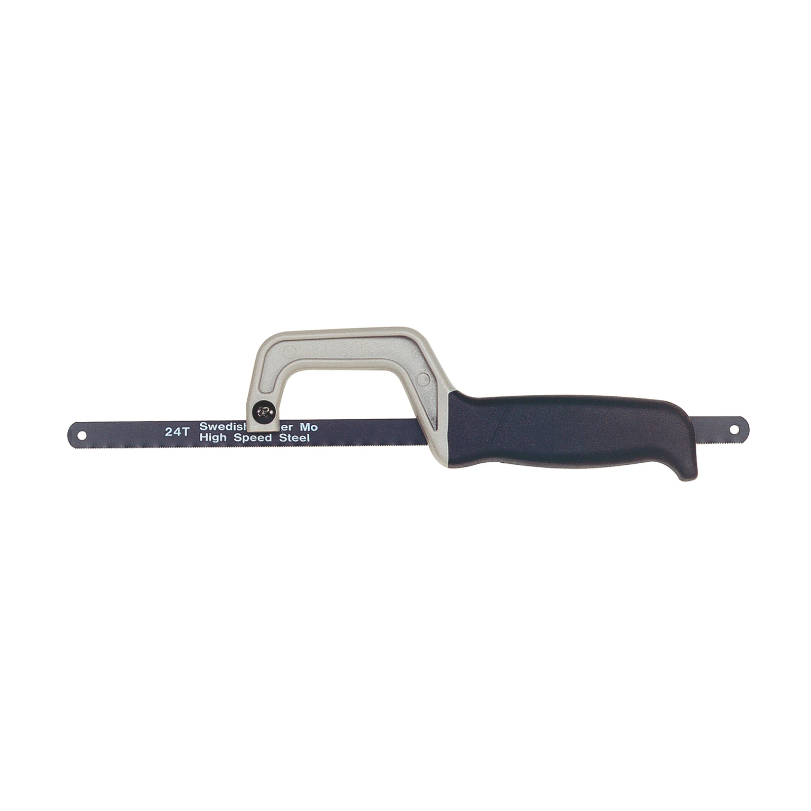

If you can't get a good angle on the post with the Sawzall then a hacksaw blade holder would work. Tedious and slow but good for cutting metal in tight spaces.

The blade on my cordless SawzAll just slides in there. I'd duct tape or painter's tape everywhere the blade might slide / touch on the frame, etc. to not booger up the adjacent areas. I hate to cut the latch post because like the hard to find under-seat locks, someday the latch posts too, will be unavailable.
