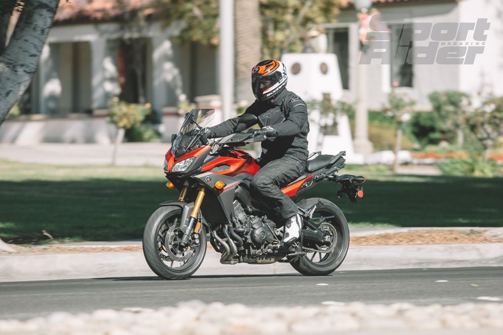

« Reply #8 on: May 19, 2024, 08:04:30 PM »
Didn't the OP say he has K75-RT?  Seems that ought to have an upright seating position and pulled back bars.  Less upright that his FJ-09?  I'm confused, but that's about par at 71, haha.
An FJ-09 has a pretty upright seating position:
I guess it depends upon how long your arms are. A couple of years ago I helped a local gal put some barbacks on a K75RT with stock RT bars. I thought it was unnecessary but she was happy with the end result.
