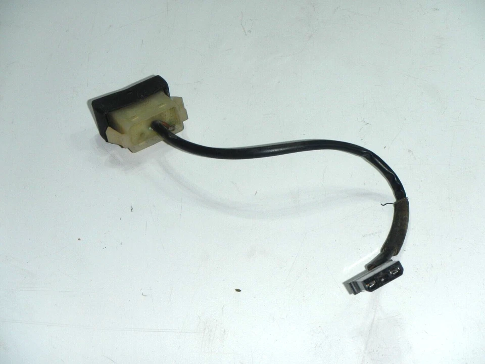

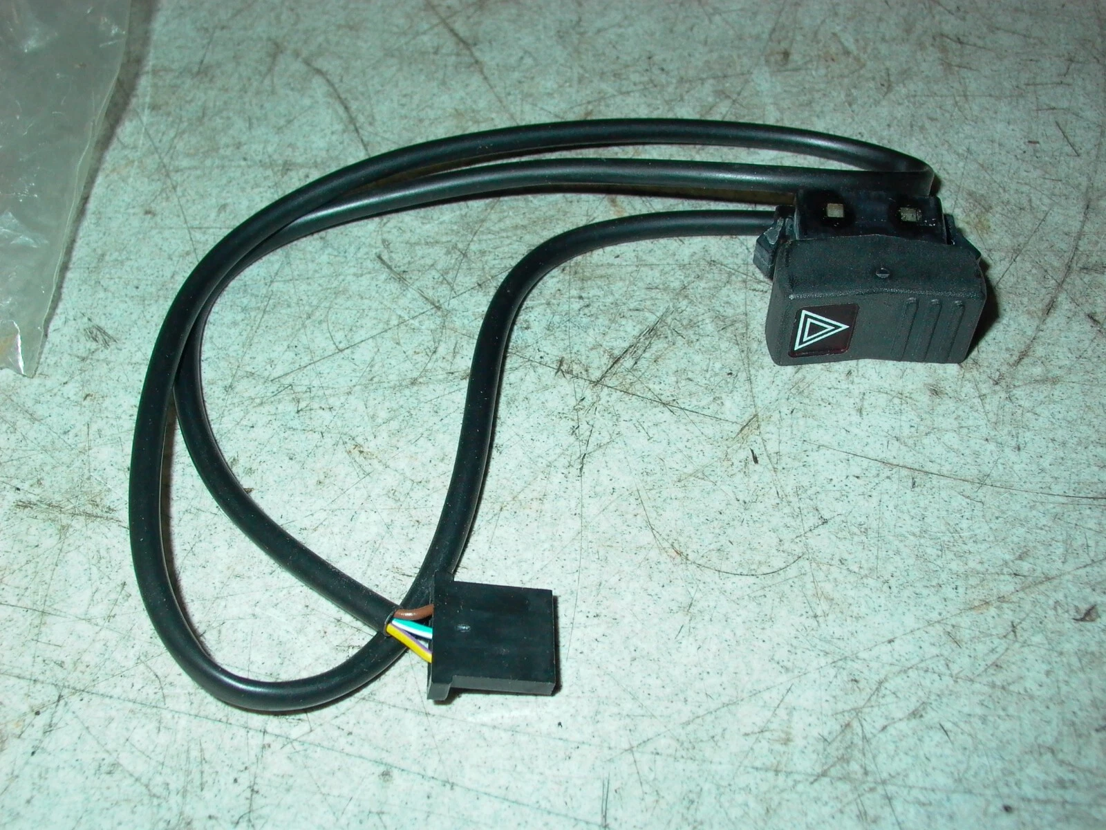

An R1100 hazard switch does have the same connector as you can see here.  However, as I noted in my earlier post, the wires on R switches are shorter so, as you can see in this pic, the wires are not long enough for a K where the wires need to go from the dash, down by the steering head and then halfway under the tank.  You can get around that by extending the wires.
R hazard switch:
K hazard switch:
  • Posts: 11648
I already received that intimation reviewing the MaxBMW fiche before I made my post, but I admit your photos are comely.
 :laughing4-giggles:
What's important now is that if Atabeach is adventuresome, R1100 leads could be modified, and cost-savings could be diverted to fuel, stamp collecting or other interests. 112350
