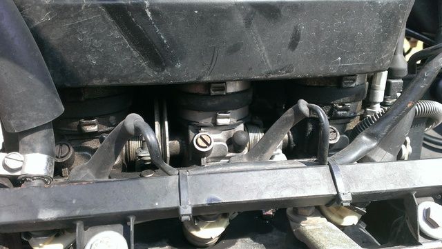

I pulled the lower fairing to have a peek at the fuel line etc. There were no leaks or sprays that I could see. The line(s) that I was able to lay eyes on were dry including the fuel pressure regulator's connections. What wasn't dry was the rear throttle body. It was wettish with black grime. The middle one was clean and dry. The front was grimy but not as bad as the rear and it wasn't wet looking. See the pic below. What could be the cause? FWIW, all three of them got a bath while I was spraying them down with carb cleaner trying to detect a vacuum leak.

The engine vent hose is near the rest TB. Check it for cracks

The crankcase breather hose? Yup, it is cracked. I can't seem to find it now on any of the online microfishies but do remember seeing it a while back.

10....Part #11 15 1 460 480.

There it is! Thanks Inge.
