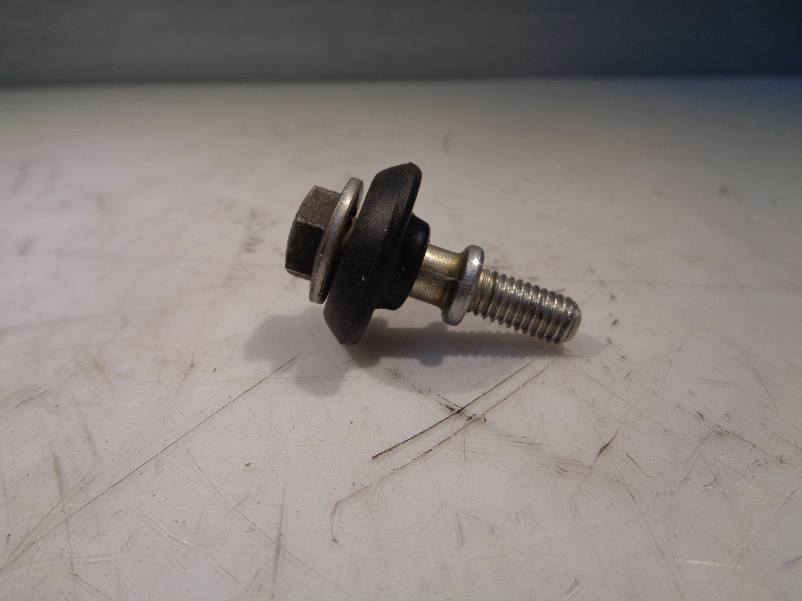

The most important thing to worry about is only torqueing the cover bolts to spec. (8 Nm)  They are shoulder bolts and if you over-tighten them you will strip the threads where they mount.
Start with the center bolts and work outward in an X pattern.
You should also replace the rubber bushings on all of those bolts - part 11141460934

What frankenduck said about replacing the rubber bushings.  Since the bolts are shouldered it's the bushings that actually apply pressure to the casting.  If they get old they might not apply enough to keep the new gasket from leaking.  And assuming you'll check valve clearances while you're in there.
