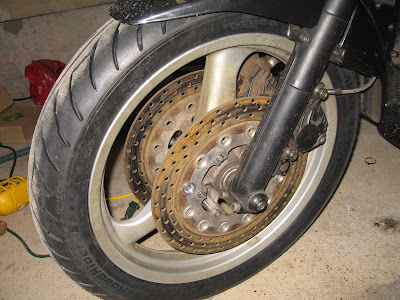

Most definitely this has been modified.  The front of the bike is completely K1004V / K1100.  The remainder of the bike is K1002V (except back wheel).  This is an image of my front wheel (18" 3 spoke with 100/90VR18 Avon Roadrider).
The brace is all metal and the brake line "Y" splitter is attached to that brace. There is a plastic cover that goes over the assembly and fastened with a long wood screw.

I'd say your best bet is to run a 110/80/18 front tire like a K1100LT runs.
From that picture it doesn't look like the front end is ALL 4V parts.  That doesn't look like a 4V front caliper:

I posted an older picture.  At the time that picture was snapped, I had 2 pot calipers from a 2V bike.  The current configuration has calipers exactly as you've pictured and I replaced the rotors with K1100 ones -- you actually sourced those rotors for me.
Tires are presently out of budget so I guess I'll leave things as they are until I am ready for new tires.  Thanks.
