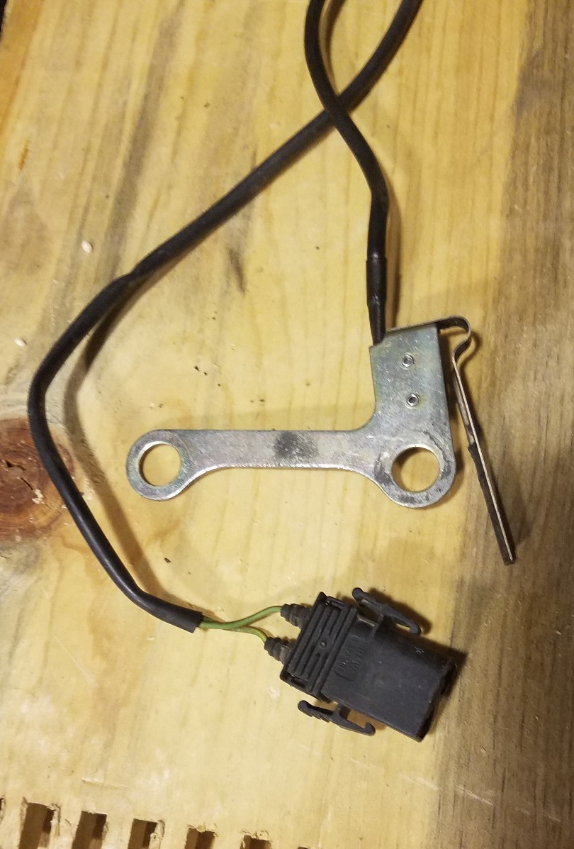

If moto is stock there's a side stand switch down there some where
Bypassing the switch http://www.motobrick.com/index.php/topic,574.msg1507.html#msg1507
You can use contact ring part number 61121459998 or whatever means necessary to bypass the switch.
The OE bypass connector
The side stand switch connector
