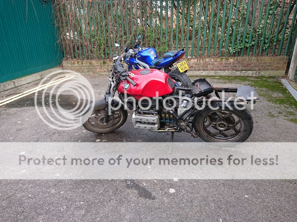

got this 88 k75s off a friend for a bottle of wine. the engine fires up and runs but cant put any gears luckely stuck in neutral. worst case cenario some ebay shopping for a gearbox.
here is a foto with no work started

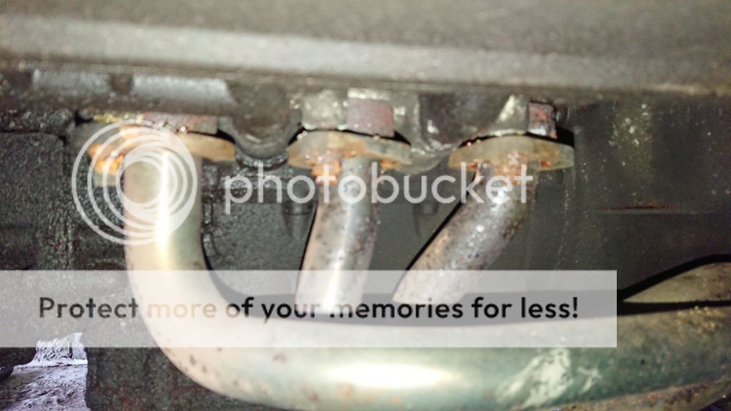

a little problem with the exhaust
a bit rusty
