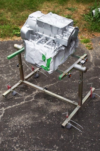

Quote from: my Blog
I setup a temporary spray booth from some scrap 1x2 lumber and vapour barrier plastic I had around the garage, stapling vapor barrier to the outside and installing a ventilation fan at the back. I laid plastic on the floor of the garage to prevent overspray from ruining the tiles.  I completely dismantled the components from the engine block and spent quite some time cleaning, degreasing and masking the engine.  I cleaned the engine block using a drill and a variety of brass wire wheels along with plenty of WD-40 to take off the engine grime.  I then used Wax and Oil Remover to degrease the block, prior to laying down the finish coat.  Once that time-consuming work was done, I set the engine block (on the movable carrier) in the spray booth and proceeded to give it several coats of the DupliColor silver engine paint.  I skipped a primer coat (as advised by others) and went straight to the Duplicolor.  I laid down 24 light coats and "baked" after each session by setting the engine out in the hot summer sun for several hours.
This work was done three years ago and the paint is still holding up. I can't stress enough the need to thoroughly clean and degrease the block prior to painting.  That is the most important step.  The next most important tip is to use light coats, almost dusting the block.  It causes a sandpaper rough surface that keys into the subsequent coats of paint and ensures no runs.  Avoid the temptation to cover in the first coats; runs are inevitable that way.   Take your time, be patient.  It took me several days to complete the job using spray cans.
