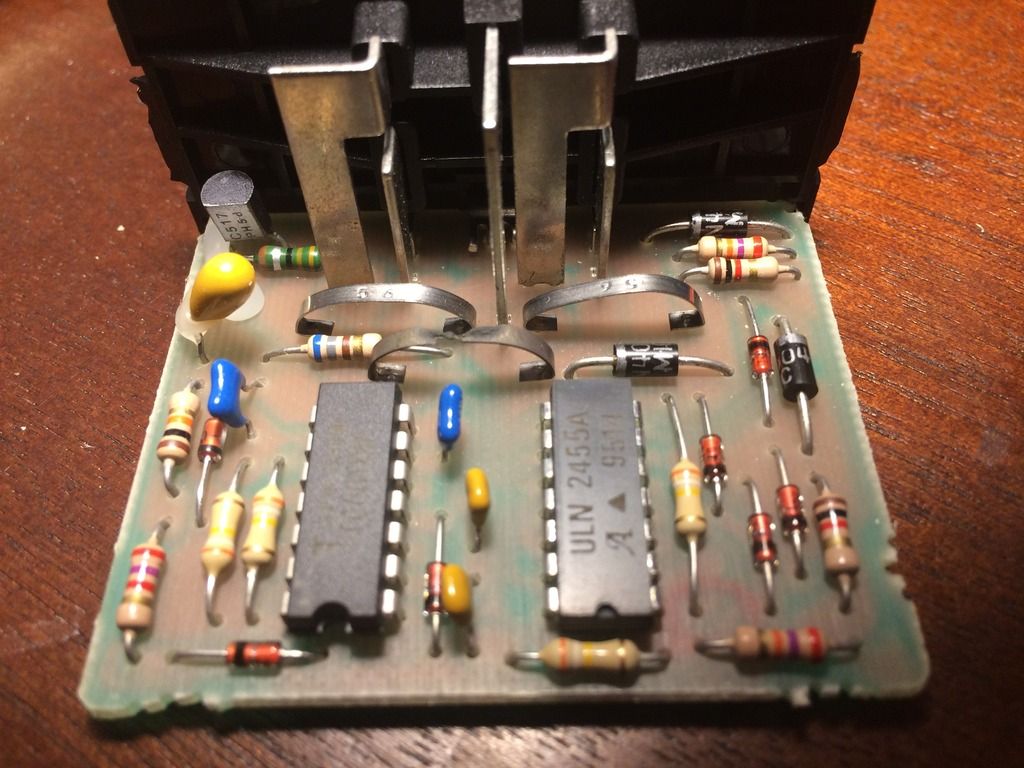

The problem was the BMU. One of the internal fused connections had blown. I disconnected the ground on the hack harness that was spliced into the stock wiring harness and routed it up to the ground wires under the tank. Now only the LED tail light for the hack is being run off the bike. The LED light bar and the amber marker light are on a separate, isolated circuit. I'm going to try and repair the other BMU and keep it for a spare.

Here's the BMU, you can probably easily identify the problem!
