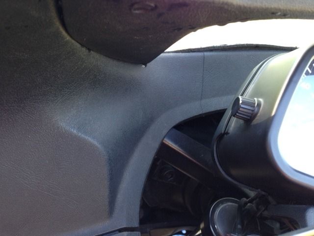

The cover that installs just below the windshield, not sure of the part name/# has cracked on my '92 RT. I've taped it to hold it.
Anyone know the name of this part #.
BikeBandit has this listed: BMW Cover Center F Loudspeaker Part #46632303230  $73.64.
They also carry: BMW Covering Center Part # 46631453173 $82.81
2nd one might be it, but not sure.  My RT doesn't have a radio.  I'm guessing that the loudspeaker part has cut-outs for the speakers (?)
Anyone got the correct info and any other sources for this?  Thanks.

That part is either styrene or an alloy of styrene known as  ABS.   I repaired mine with some thin ABS thermoforming sheet from a plastics supply and some ABS pipe cement.   The repair worked very well and made the part usable until I was able to get a good one from a guy building a latte racer.

You're correct on the part being "46 63 1 453 173 Covering center"  Still available from MAX BMW for $82.81.
Mine cracked in about the same position and if I may reflect, that part is too weak, too flimsy and too thin for attempts at welding....I tried welding, epoxying and both ended up breaking again.  The "tabs" where the glove box mounts attach can be cracked as well, so I just replaced it and no longer think about it.  Just my .02.
It's simple to replace - Screen comes off, then the "Panel"
(look here http://www.maxbmwmotorcycles.com/fiche/DiagramsMain.aspx?vid=51743&rnd=12082016) under section 46, Frame, Fairing, Cases // Then Windshield/Mounting parts
Then remove the four glovebox mount screws (2 each side) and you can then slide it rearward off the fairing. When remounting the screen, remember to check for proper alignment of the M5 body nuts that the windshield screws thread into.  They can bend and deform- so when you go to thread the screws back in, they won't take and just spin.
