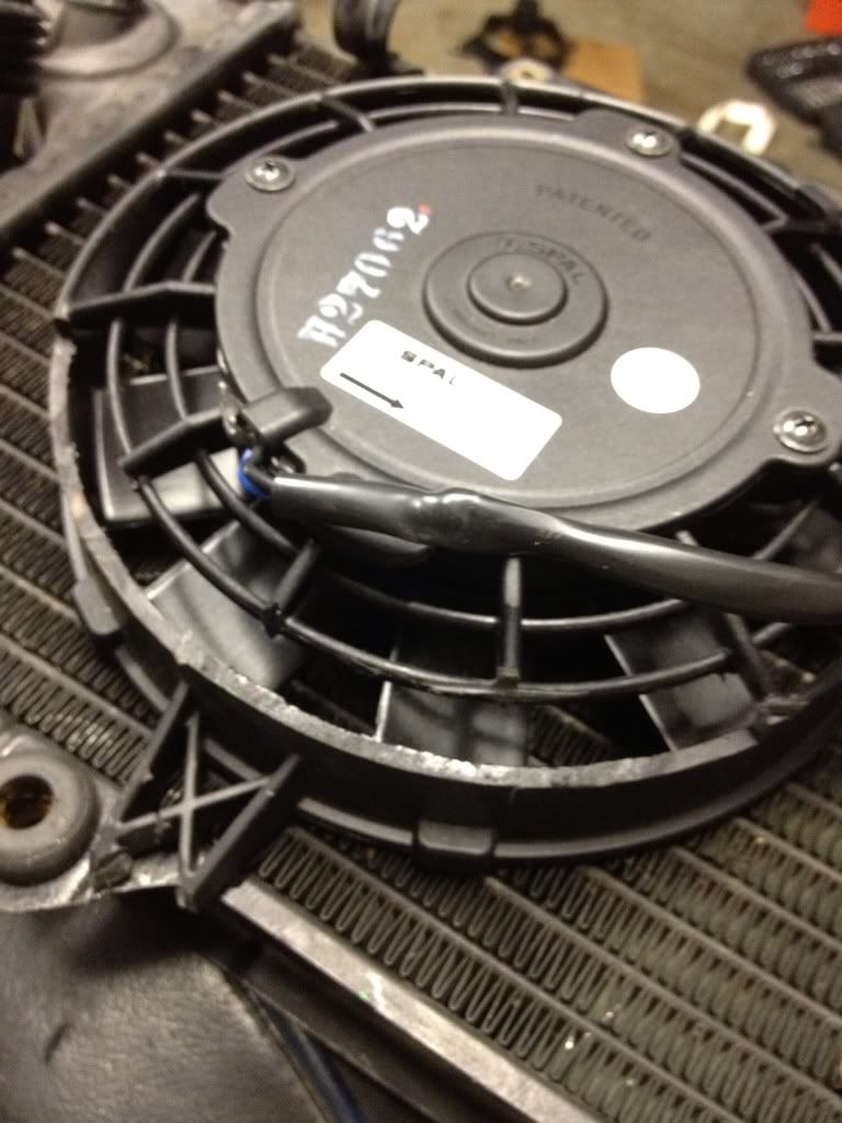

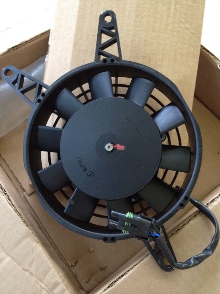

Then I unwrapped my new Spal 6.5" fan which was packaged nicely.
The Spal fan lined up perfectly with the two mounting holes on the bottom. On the top the hole is about an inch off so I fashioned a bracket for it. After all that work when trying to install it I realized the fan housing and the bracket would barely hit the frame (2-3mm).  :hmm:
So after some more looking and thinking I removed a small section of the top of the fan housing with a dremel and a part of the top mount. The mount presses up against the frame so there was no need to bolt it on anyways and the fan fit nicely in place.
Sorry for the blurry picture, but if you look closely you will see where the top 1/3 of the outside housing has been trimmed back and the top mounting hole is gone.

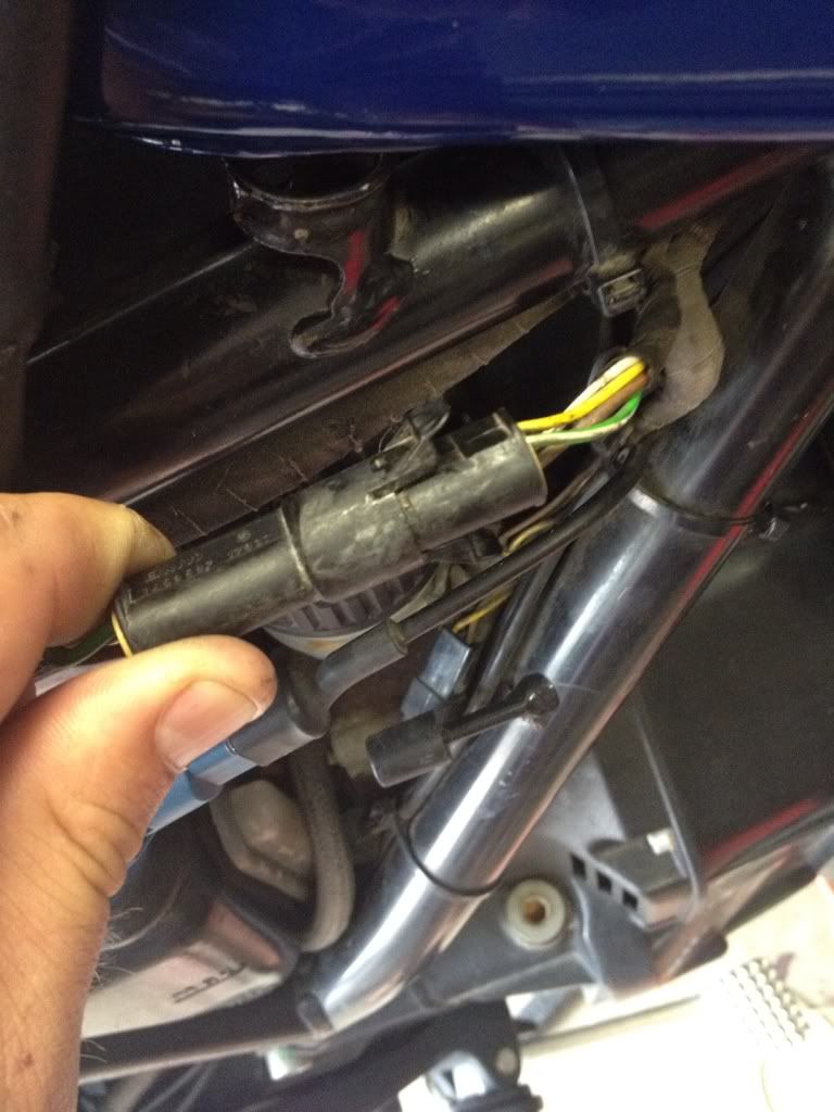

Next I clipped of the connection that came with the fan and soldered it to the old plug head. Threw everything back on the bike and finally got to take it for a spin after a couple long weeks of waiting.

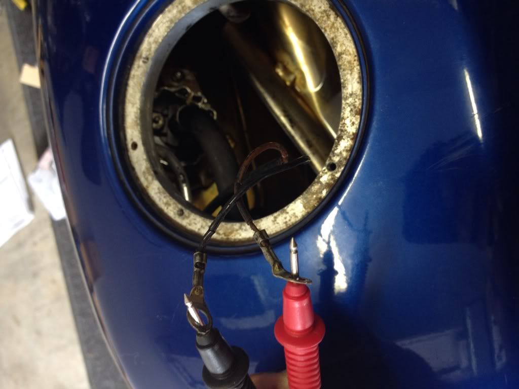

Fuel Pump harness connection. I tested the green/white wire on the bike side of the harness
I got around 11.4v, I cleaned the connectors with contact cleaner again and got the same.
Next I tested the connection at the fuel pump itself. I unclipped the pump from the tank and pulled it our enough to unscrew the connections. I also got 11.4 at these
Next I tested the battery and ground it to the frame it read right around 12.8v
So???? Will the pump not fire at all unless it gets at least 12v? Is a loss of about .6v enough to screw things up? Where should I troubleshoot next? Thanks again
Also I forget to mention, when we stopped to shop the fan was on when I turned off the bike, would this have any affect on draining the electrical system/battery? It doesn't seem likely it did if my battery is now reading 12.8V.
Just trying to think of everything here without giving up and replacing the fuel pump. Is there a safe way to test the pump directly?

Ok, Tested the pump directly.
Ran wires from the battery directly to the pump. It kind of jolted a bit and everytime I touched the battery, but didn't "stay" on.
No muck in the tank at all, but I did remove the float off of the gauge when I went through the tank to clean it.  The float is filled with gas and no longer floating. Without the float would this "tell" the system there is no gas and cause the pump not to run?
