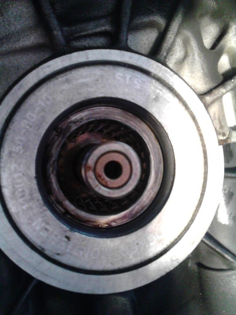

This morning I've removed the clutch basket. There wasn't any oil leak but since I've already bought a replacement main seal and a couple spare o rings I thought I might as well change 'em out while I'm in here.
Thing is, mine looks different behind there than anything I can find online:
There's this aluminium looking metal ring infront of the main seal, with no obvious way to extract it....
 There's a little oil in there, and actually when I gave it a wipe down there came away a couple of tiny fragments of rubber. So I do wanna swap that seal now! I've seen various threads on different forums for trying to get it out, but nobody mentions the ally plate in front of it. It has some German written on there, 'Trockenmontiern' and some numbers.....
Top tips?!
K.

Sorry, fussing about nothing. It's just a different type of seal. Got it out. Got my nice new one in. Sprayed a little solvent in there too thanks Gryphon.

What you are talking about is the face of the oil seal.  There are several ways to get it out.  The most straightforward is to just pry it out.  If that doesn't work, you can drill a pair of hols in the face and put in a couple sheet metal screws that you can pull on.
The rubber bits that you mention are probably from the clutch o-ring.  The o-ring gets pretty torn up in the process of pulling the clutch basket out.
While you have the basket out, make sure you go into that space behind the oil seal and spray some degreaser on the face of the balance shaft at the bottom of that space.  Do it just before you reassemble.  That oily face will give the balancer the opportunity to move around and cause a nasty clank at idle.
BTW, how is the fit of the clutch rod in that hole in the end of the output shaft?  How's the fit in the diaphragm spring bushing?
