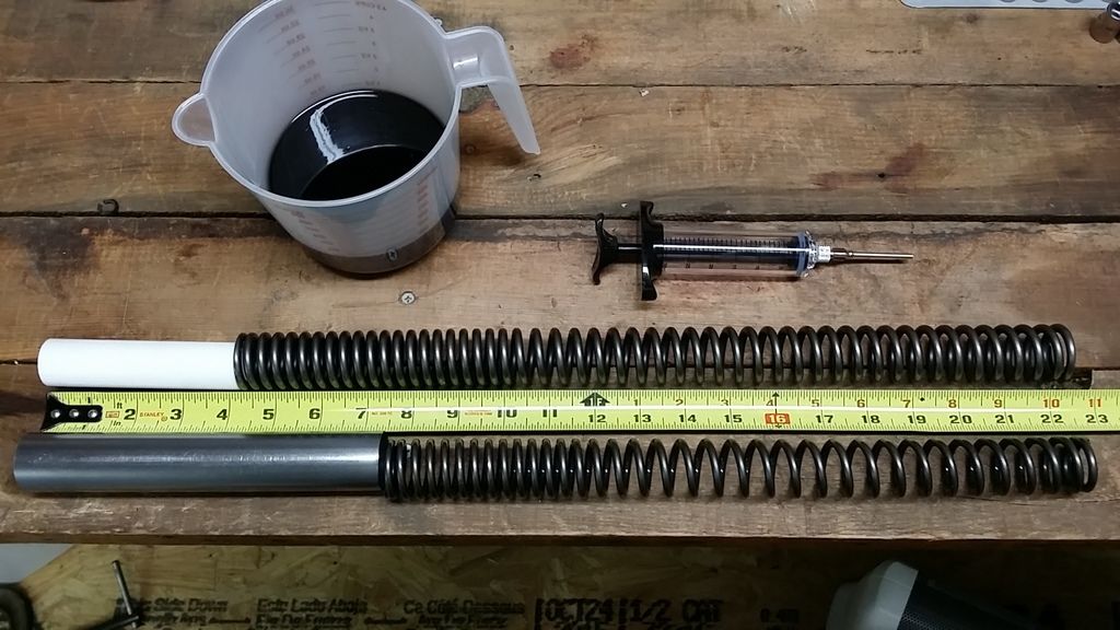

During my last ride of 2015 (literally) I noticed that my left fork seal was leaking.  This bike was new to me in 2014, so I decided to open up the forks and see what was inside.  I was on the fence about upgrading to progressive springs, but... after a last-minute internet search, I found a pair of Progressive Suspension springs for my '92 K75 for $47 + ship from Dennis Kirk.  Decision made.
Last night I discovered that the bike already had progressive springs!  My first thought was that I'd either return the new springs for refund or re-sell them to the motobrick community.  After laying both springs side-by-side, I noticed the following:
     - new spring length (18.0") + new PVC spacer (4.25") = 22.25" overall (top in photo below)
     - new spring coil = 1.28" o.d.
     - new spring wire = 0.28" o.d.
     - new spring weight = 23.2 oz. each
     - orig spring length (14.75") + orig metal spacer (7.5") = 22.25" overall (bottom in photo below)
     - orig spring coil = 1.26" o.d.
     - orig spring wire = 0.26" o.d.
     - orig spring weight - 13.3 oz. each
I guess I'll keep the new Progressive Suspension springs after all (more metal is better than less, right?).  Any clues to brand of "original" prorgessive fork springs?

Maybe the previous owner wanted a firm ride? Stick with the new springs.
There needs to be a metal shim / washer (part # 31422312835 on my bike) between the PVC spacer and the metal spring too. Otherwise the spacer might get chewed up and sprinkle PVC chips into the works below.
