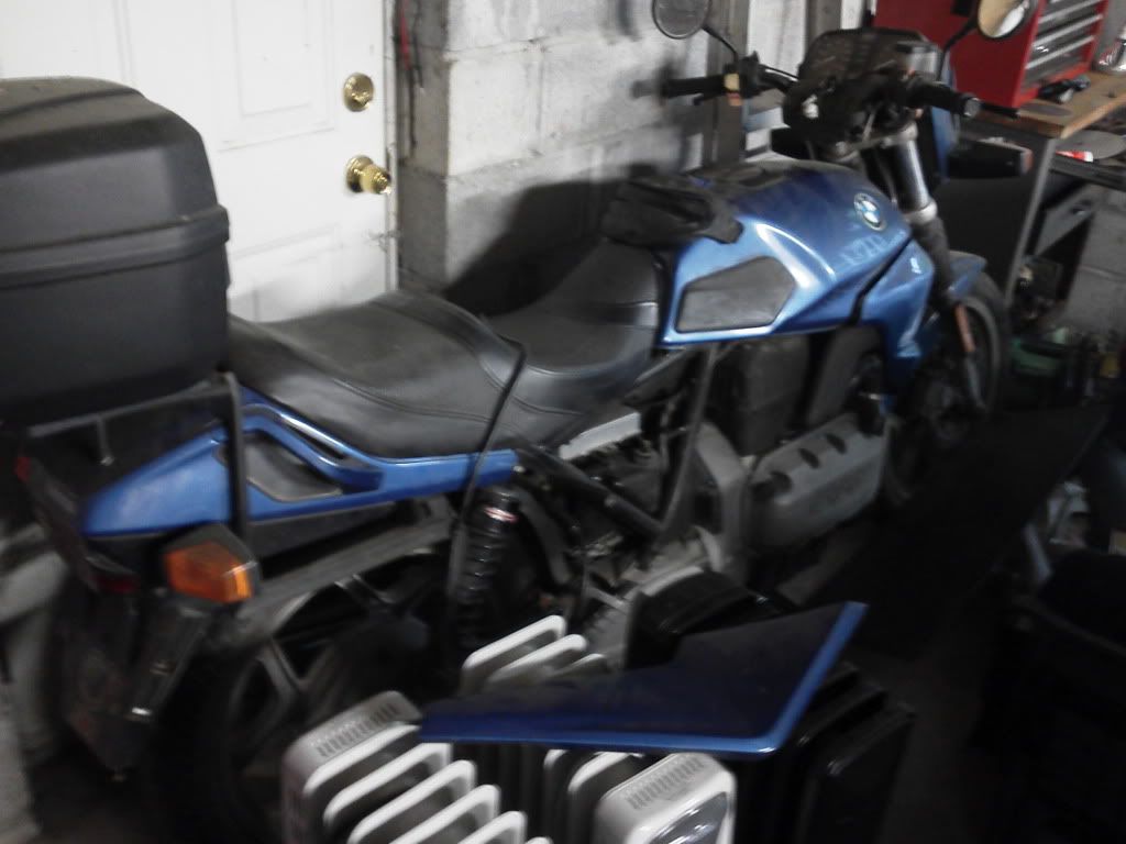

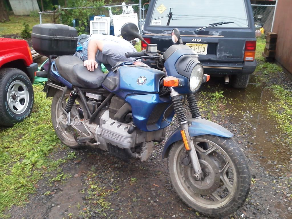

Hows it going guys. I have a i believe '86 k75s? Im not 100% sure haha ive had it about 2 years, i traded a friend some work for it and i am finally now getting around to working on it. the bike sat for a few years with gas in the tank  :musicboohoo: so the ethinal destroyed everything. I got a new pump out of a mustang, i read the works just as well. But now the issue i am having is since the fuel sending unit is all corroded i cant get power to the pump. trying to find a sending unit has been about as successful as me winning the lotto. I was wondering if anyone know any other tricks to get the bike running. I am at the point where i just wanna put an external electrical pump on it haha  :clap:
I am told by my pops and the guy i got it from its a nice bike and a lot of fun to ride. Im a woods rider so it seems bulky as hell to me haha here are some pics. Im told it has a corbin seat, and progressive suspension  :eek:
PLEASE HELP ME HAHA I WANNA RIDE THIS THING FIANLLY!!!  :clap:

Given the overall good yet dusty look of the bike in your photos, and the fact that it has a custom seat, rear rack and shock upgrade, I'd guess the bike was likely well-cared for, at least at some point.
If it's got <100k miles on it and you're employed it's probably worth your time to get it back on the road.
