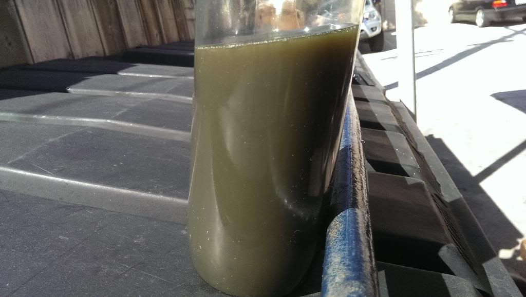

so this effluent came out of my transmission...
« on: April 28, 2014, 08:30:14 PM »
"This can't be normal, can it doc?", exclaimed an obviously distraught leprechaun after his enema.

« Reply #3 on: April 29, 2014, 12:16:40 AM »
I'd be more concerned with consistency than color.

Reminds me of my juice from a few months back.. I changed the oil but haven't really checked up on the new one yet.

Water got into my Ural's gearbox and the oil came out looking like a runny vanilla milkshake.  Caught it soon enough, no harm done.

I had the same stuff in a bsa Gearbox... Took three or four changes to get it out.

Any metal shavings on the drain plug or just the water contaminated gear oil?  The drive oil in my Mercruiser looked like that when a seal failed on the propeller shaft.
Think I'd go with Mobil1 with Guard Dog Moly in the trans and FD.
There were some. They were not solid, looked spikey then smeared/dissolved between fingers. Not sure how normal that is. I did use mobil 1 (75-w90) but have not added the guard dog moly yet (does anyone sell that or do i need to order from their site?)

Going back to the original picture,the "effluent" may not be too bad.Rubbing between thumb & forefinger gives crude indication of oil state:any feeling of grittiness would be a cause of concern.Personally I would put it through a fine strainer or cloth to see what crap was in it.Unfortunately the detergents/additives in modern oils keep crap in suspension & it don't take a lot of moisture to give that look.A K bike gearbox is a little different to use compared to Jap bikes I have owned so if you can meet another motobricker & compare might be your best bet
