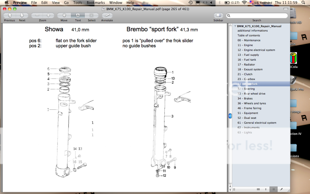

I'm getting parts ordered. I'm wondering which forks I need to get seals for. BMW of Countryside has two different types (Brembo and Showa, I believe). I have a 1986 K75 will I be needing the Showa seals? Also, which seals will I need. I looked int the library and the write up was more about later K's and the Hayes manuel is unclear to me which I need to buy for as well. Sorry if this is an obvious question.

I thought Showa forks were mid-1991 and later but I'm not sure.
There's a VIN decoder at http://www.bmw-z1.com/VIN/VINdecode-e.cgi and at http://www.realoem.com/bmw/select.do

Thanks again. The decoder showed that it is a K75C produced in 11/1985 (which explains the registration for '86). The fairing must have been added sometime during its life. After comparing a picture of my fork to the two in the Hayes it seems to me that I have Brembo forks. It also appears I really need to give my bike a good scrub. Stop me if I'm wrong. Would it be smart to do both right away? Here are the pics:

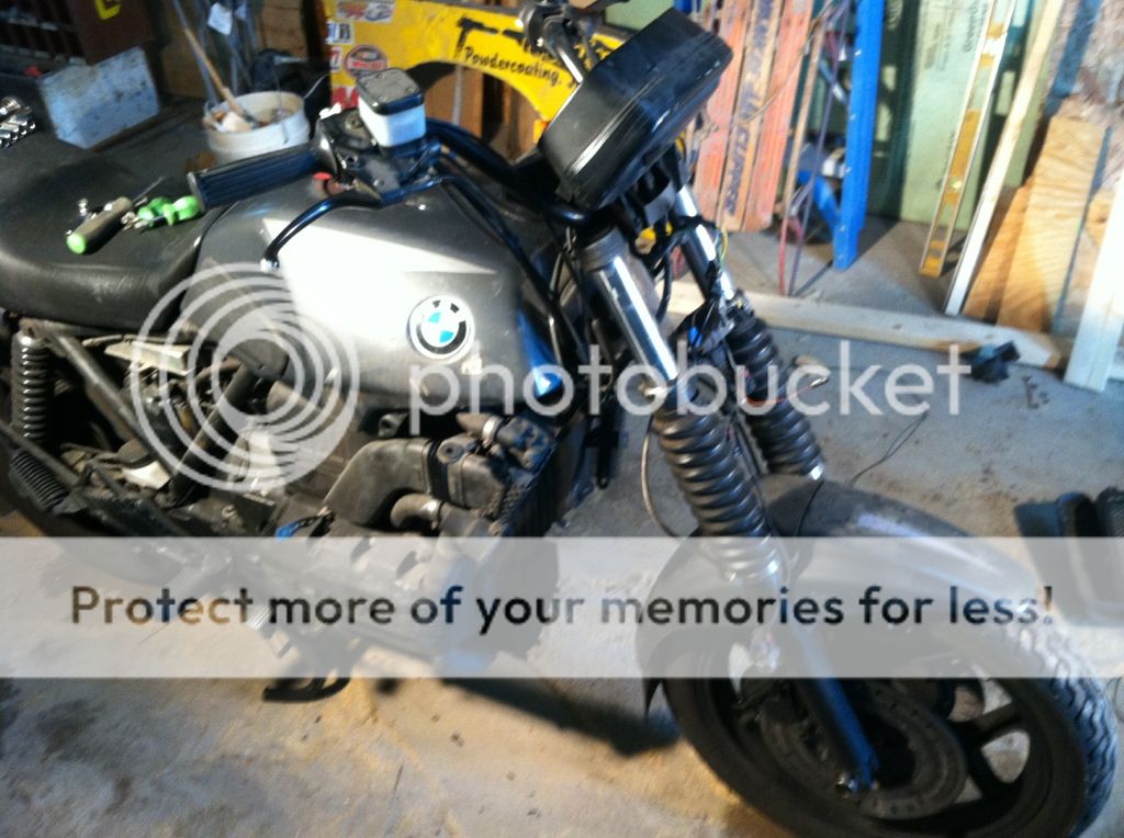

I got everything started today. I got the RT fairing off. I was rather disappointed with just how beat up the fairing was. Whoever owned it before me did not treat it too kindly. I was following the nice instructions in the library, but soon those, unfortunately, didn't help (though they are great in structions). It was just a cobbled together mess of bent metal, not very good wiring, and repaired fiberglass. However, at the same time, I'm glad it is off. The wiring needs a good going over as it too was poorly repaired. Oh well, tomorrow I'll get the spline tear down done and ready for the guard dog moly coming in the mail as well as the other parts. Also, lots of powdercoating will be happening and ceramic coating the exhaust. Here's some pics:
Last pic as an RT:
Torn down:
Sketchy wiring:
The previous owner fitted a fuel cooler, which I may delete (I don't know where I'd mount it) and find some insulation (I already got some great ideas from the thread on it):

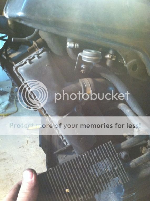

The tank was not clipped down properly, good thing I never put her down. There was also a rats nest (literally) under the tank along with more wiring that needs to be replaced:

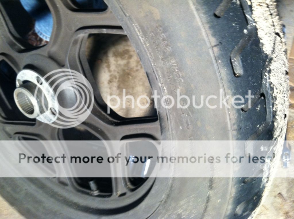

The rear tire was mounted with the rotation the wrong way:

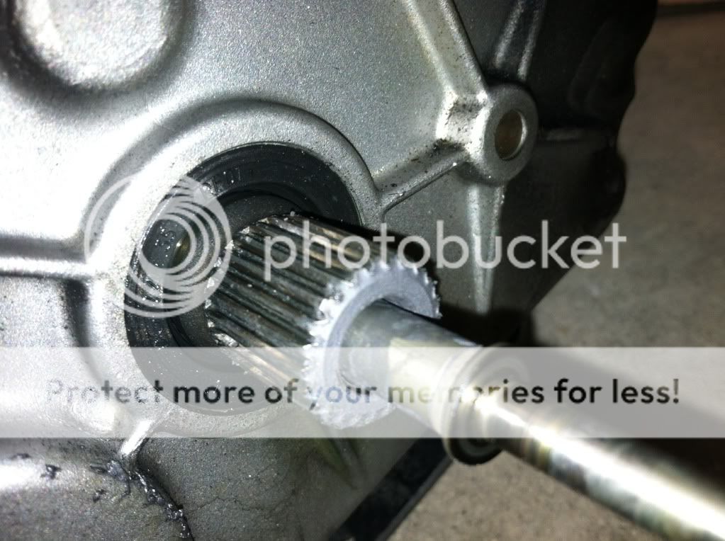

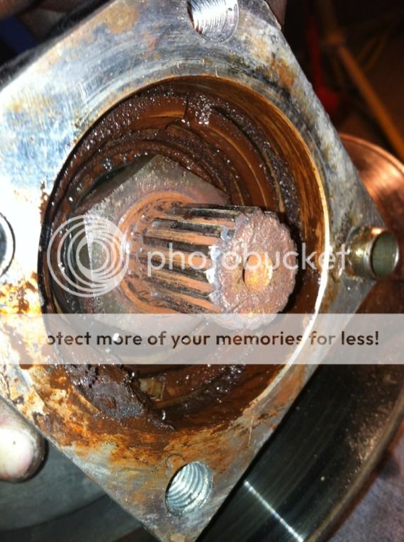

The final spline is in pretty rough shape, I'm not sure if its worth putting back on:

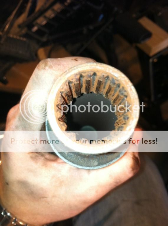

I'm also not sure about the drive shaft:

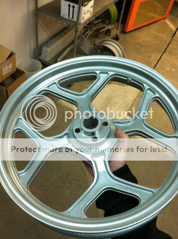

Things are coming along slowly now that I'm not at home, but there is some progress. My dad got the wheels powdercoated. I think they look pretty nice.

I'm sure you can get another 20k or better out of that rear spline. Always think in terms of "the load is spread out over 16 of these warn splines". Grease, at least, pretty much stops the wear where you were at before tear down. If still concerned, there are several guys that can repair the splines to "better than new" condition out there. Check other posts.

Thanks for the input, breikes. I was thinking along similar lines as you, just grease it up well and put it back together. I ordered some Moly Guard Dog which is supposed to be some stellar stuff. Also, perhaps I'll lube the final spline more often since it doesn't take too long and that'll ensure that the splines are well lubricated.

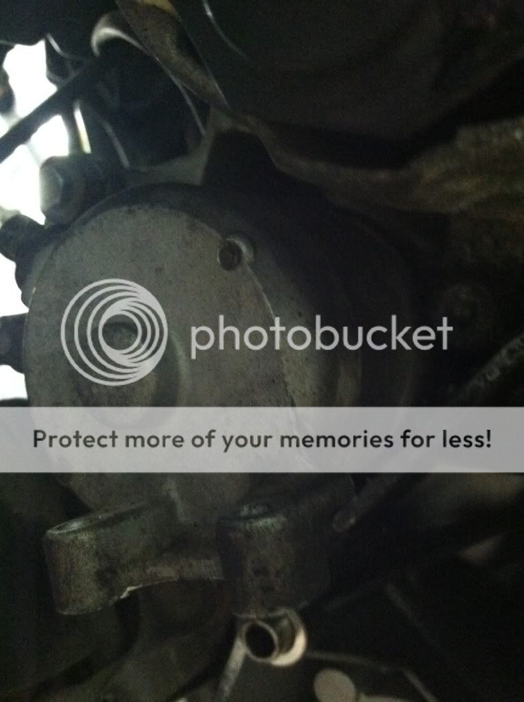

Well, finals are over and I'm bak at it. I got some time to get the transmission out. The splines look fine, just a bit dry. I am having trouble getting the starter out though (I was going to give it a quick clean). I checked the manual online here and I've done everything. It seems like I'm just missing something.

You're just not pulling hard enough.  The only thing holding the starte in at the stage you've got it is its O-ring.  It probably is tight because of age.  Getting a good grip on the starter inside of the battery area is difficult.  Wiggling the starter body side to side as best as possible as well as rotating the body whilst pulling should help to break the seal.

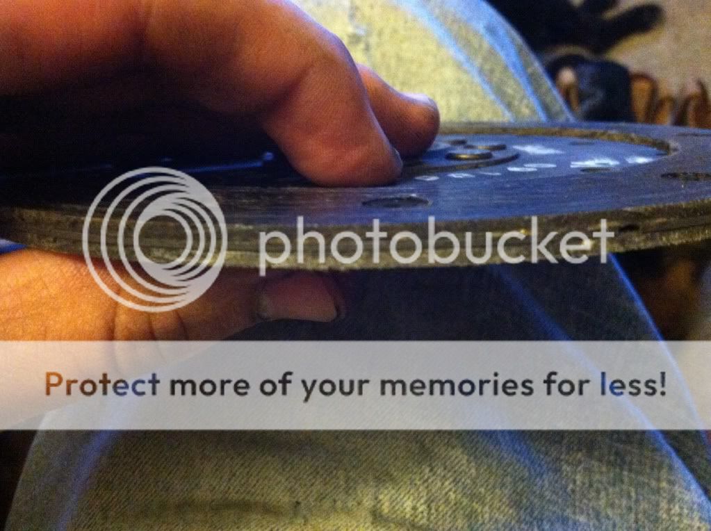

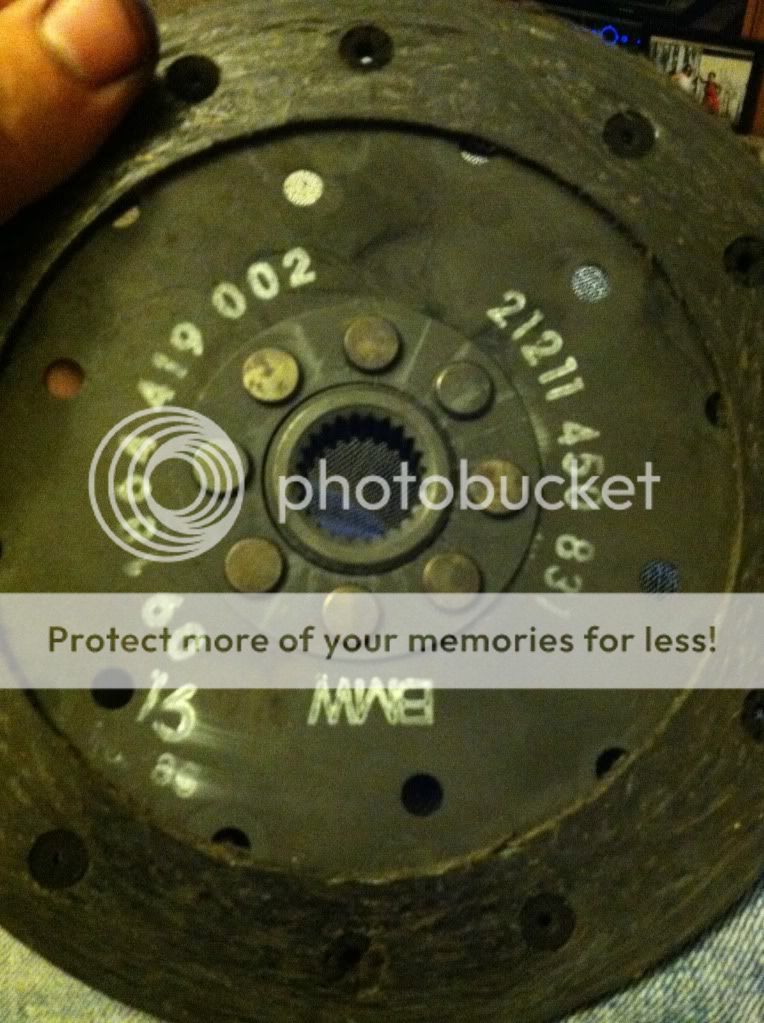

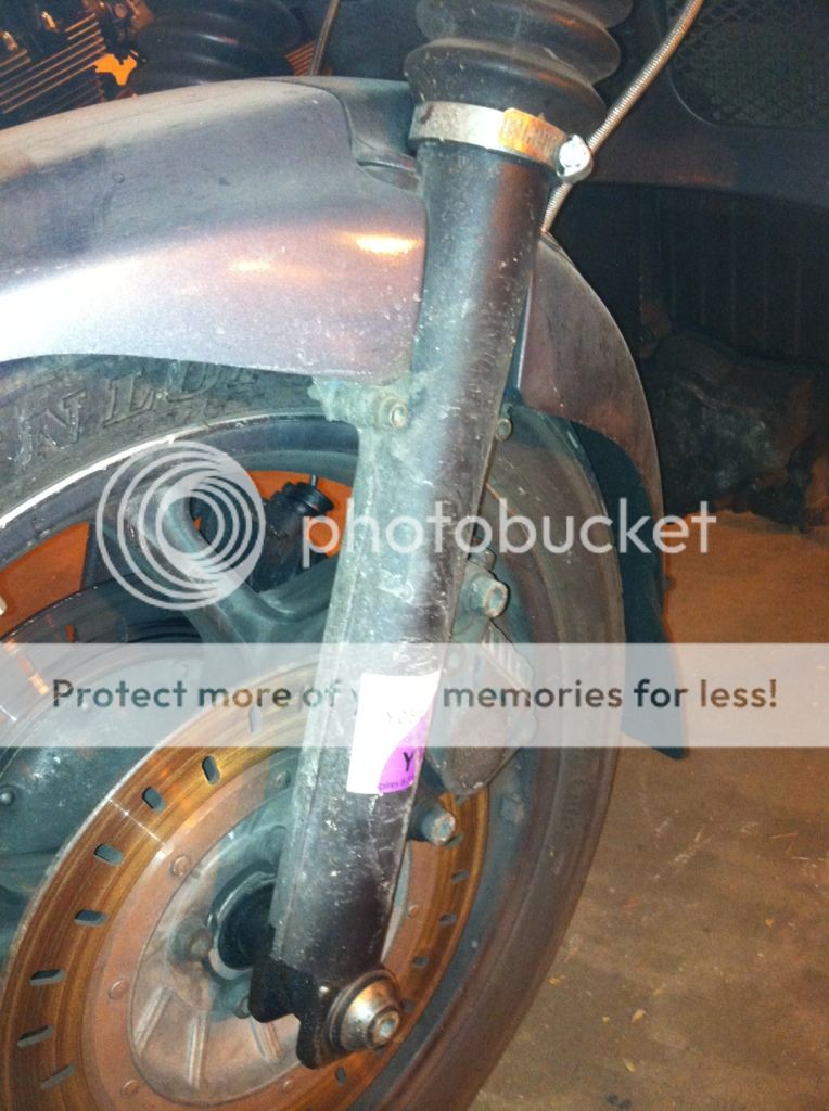

Thanks rbm, with a little help I got the starter out, it was a bugger though. I also got the forks off to powdercoat them and renew the seals. Also looked at the clutch plate it is pretty worn it is at .194 inches. I am not able to find the minimum, but I'm assuming by the looks of it, it is quite time for a new one.

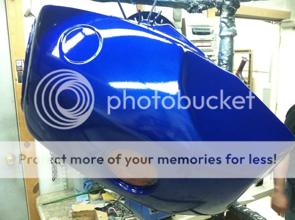

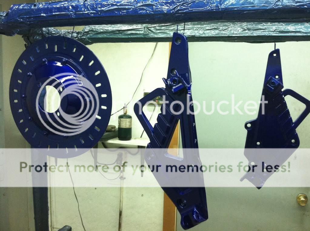

Things are going a bit slow, but my Dad and I powdercoated the tank, front rotors and foot peg mounts today.

I have to admit though that I'm very surprised that you powder coated your front rotor.  don't you need those to stop?  Do you now grind the powder coat off or can you really get your brakes to grab them that way?
Educate me please.
Re: Spring Break Wrenching
« Reply #17 on: June 22, 2013, 09:00:19 AM »
i have seen powder coated rotors in socal... soon will have the powder coat worn off where the pads meet the rotors... hear its kinda dicey till then...
Offline sembrando
  • Posts: 74
  • Started on a Beemer...Never looked back.
« Reply #18 on: June 23, 2013, 03:38:50 AM »
Yeah, we do it often enough, though more on cars than bikes. The powder wears off pretty quickly, but until then just be gentle. Hopefully I can get her rideable this week. All I need is some fork oil and some time to put everything back together. Any suggestions on fork oil? I've heard honda 10w. I'm not looking for something super sporty, but some sport that can handle bumpy St. Paul streets.

Wow, I apologize for my complete and utter absence for the past several months. I'm sure you've all forgotten about this whole deal, but I've had my bike done (or close enough) for over three months and about 4,000 miles ago. I love the naked look and I get a ton of rubberneckers wanting to know more about it. Only problem has been a fork leak from the plug (stripped the threading  :mbird ) and the gas getting hot and when the tank is full pushing gas out of the filler (I need to replace the insulation I removed to redo the tank). I will probably look into a windshield for the cold/freeway riding days. Also, I found a belly pan in decent shape so I may attach that this winter for a little bit more sporty look along with some lowered handlebars. I need to paint the engine better too. With the weight of the faring off of the front wheel I've noticed a little bit more spunk in acceleration and a lot more stable cornering. I'm certainly glad I did it, it fits my mostly city driving situation. I am up for any suggestions, comments, concerns, and pious indignations.
Picture of me and my lil sis starting a nice ride down the ol' Miss down the Minnesota/Iowa side and up WI.
