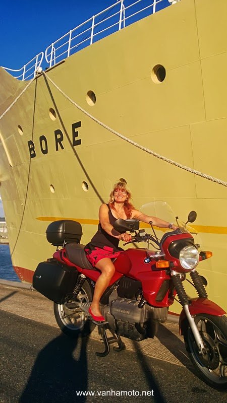

A small update - some of You are already familiar with me and I'm getting to know you all. My wife Viivi loves this BMW - it's so much better especially for the passenger (even though she says she loves the vibration of the CX...). K75 offers so smooth riding!
TPS and injection are now adjusted (a motorbike service did it for me) and all other adjustments checked - runs better but no effect on backfire. On the other hand - I'm getting used to that.
I bought a new windshield and now it looks great! http://www.vanhamoto.net/2013/07/plekseja-saa-vanhoihinkin-pyoriin.html
I've bought a new top box rack (Hepco&Becker) on which you can mount any top box.
