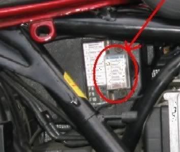

There's a lot a high $$$ fancy schmancy ones out there but I've been using these for quite some time. They are inexpensive and with some minor rearrangement in the relay box you can mount them right next to the factory fuse block.
On my K1100RS:
On my K75F:
Once I've got the flasher relay out of the way, I take a 1" wood bit and drill a hole next to the OEM fuse block. Then I install a grommet and route all of the wiring as necessary.(The first one I installed on my LT without the hole and just ran the wires around the back of the relay box. Slightly less work but not as clean of an install IMO.)
And voila!
