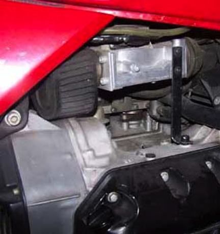

You can do this;

You can do this;

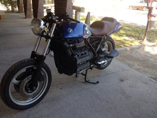

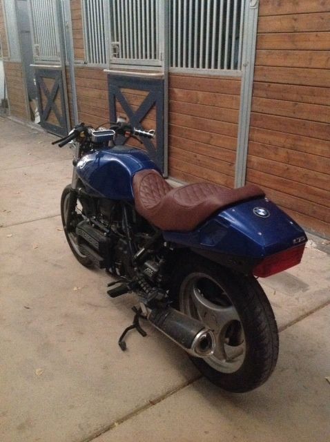

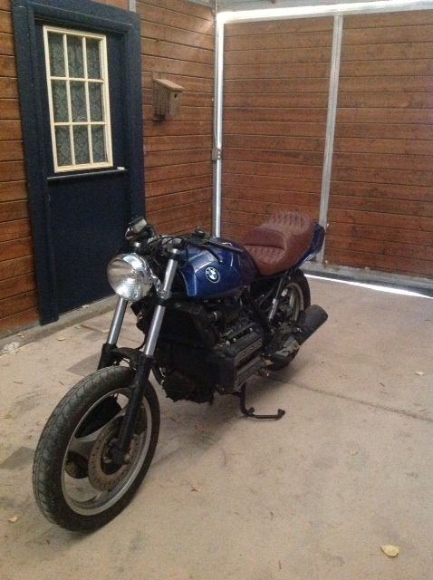

Nice.  Looks like this is on the right hand side of the bike right?  What size of filter did you have to use? Any special mods that needed to be done?  I'm starting to make my 1992 K75 into a cafe style bike.  I've seen some amazing cake K's!

« Reply #9 on: September 10, 2012, 07:33:49 PM »
There was a Luftmeister kit to do this;
But you can do it your self. Just get a K+N filter, the one on their kit was;
From K+N WEB site;
RU-2450      1.75" Flange Dia.(44mm) - 2.75" Length (70mm)
                  4"x3" Base Oval Dia.(102x76mm)  top 3.5"x 2.5" (89x64mm)
                  0.625" Flange Length (16mm)
        Flange offset 0.5" (13mm)
        Flange angle 0 degrees
The flange can be made from a turbo blow off flange from Ebay. The kit plate measures;
The bolt hole centers on the plate are 71x30mm.
The plate is 93x52mm with a 15 mm high flange,
OD of the flange is 47mm.

Yea I wasn't looking for any performance enhancement just for looks.  Thanx for the detailed specs!  Shouldn't be to hard to rig that up.  I looked through the special K section and there are some great bikes.  When I get some extra cash I will be chopping down the backside of the bike so I can get a smaller custom seat o and get a lower rear shock so I can flat foot it instead of using my toes lol I'm 5'8" not to short but these bikes sit high to me.
