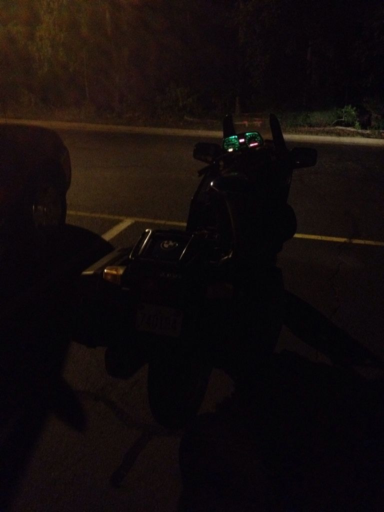

I've had a bit of an ongoing problem that's getting progressively worse. Every now and then I lose all lights in the rear (brake, license plate, etc) and the BMU light would come on. Then I'd ride a bit more and they'd come back.
I've checked bulbs, contacts, fuses and I'm not really sure where to got from here.
Before I ever have a chance to go in with a multimeter and really dig they come back on.
Has anybody else had this happen and/or know where a good place to start would be? I'd really appreciate it.
Here it is not working, notice the headlight and lights on the cluster are on.
Then I moved it 40 ft. to the guest parking because I have family coming to visit tomorrow and they come back on.
I have a sneaking suspicion that it has something to do with whatever this black box is.

That box is not stock. Was someone trying to make running lights out of the blinkers possibly?
I'd trace down those wires an remove the box if possible. There should be like 4 wires going to
 the back of the bike...

Randy - Someone DID make running lights out of the blinkers, I figured it was stock.
Thanks everyone, I'll start tracing the ground wire and do some diggin on that box and report back.

It's been raining off and on all day so I didn't want to trace the ground, but I found out some info about my mystery box.
It is a running light unit, I found the company's website too.
http://www.soundoffrec.com/products/lights.aspx
I'd take it out, but I like the extra light in the back and am afraid of how chopped up the wires may be.
If I can't find a problem elsewhere then it'll have to go.
