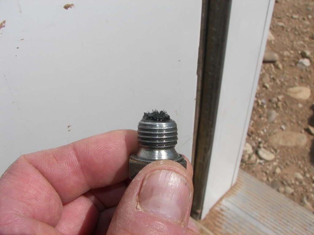

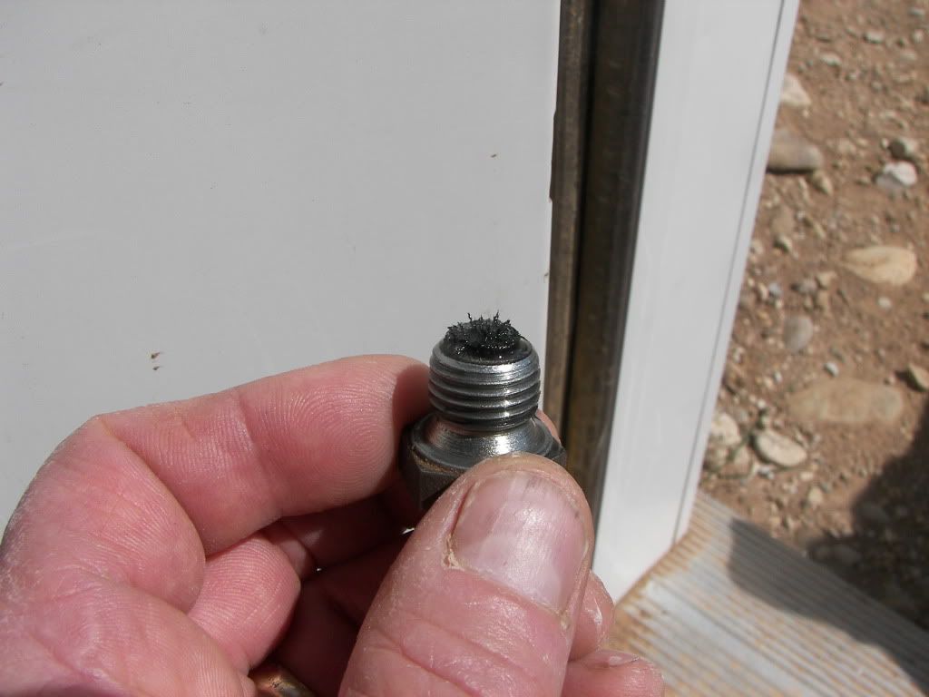

This is what I found 1,100mi after changing th' gear oil:
Is it even worth putting the Guard Dog in, or should I start shoppin' for a used or rebuilt trans?

That does look like a lot of fuzz for only 1100 miles.  How is it shifting?

Have you done a spline lube on the input shaft. If that is dry you will get a clunky trans and that could well cause the fragments in the magnet.

  To answer your question Rick G, the machine just ticked over 33,000 today, and the splines were lubed at 28,161. But- that spline lube happened back in '01. Poor ol' Chile Red suffered about ten years of serious neglect in the back of PO's garage gathering dust. Makes me sad think of how lonesome she must've felt. So I'm wondering - even though the milage since spline lube was low, that it might possible for the grease to have dried out somewhat in 11 years, thus necessitating that I consult the L Duck Hubbard Splientology manual a bit sooner than I had anticipated.
