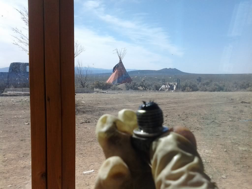

And - this is what I found when I drained the tranny gear oil:
(Stoopid camera phone does not do closeups very well)
The machine has 30,000m on it, and the gear oil was last changed at 9,200. So should I be concerned, or is this a normal amount of filings for that kinda mileage? Overfilled the gearbox just a tad too by putting a whole quart in, hopefully this is not enuf to worry about.

About metal on the drain plug...you gonna find it there next time too.
Put some of this metal between your fingertips....and you would feel that it`s microscopic particles.
If not....it`s time to get concerned.

Thanks Inge K. - Hmm... more like steel filings than microscopic particles, and there seemed to be a couple of largish flakes in there too. If you look to the left of center of the top of the plug, you can see one of 'em, albeit fuzzily.

A picture of the drain plug in focus would help.

Ya ,hard to tell what the metal matter looks like from your photo. If it just magnetic fuzz OK, chunks of metal are a different story. (shifting forks wear & tear)
Are you concerned because you found a teepee in your transmission?

Ha Ha - but the mound of metal shavings on the plug was somewhat tipi shaped, or maybe more like a sweat lodge :lol:

Looking back, I'm thinking of how I ran th' Beest for about 800mi after I got it, some of 'em hard miles too, with the gear oil being down by about a third to half or more  :yow.
No idea how many miles that state of affairs existed before I took ownership. Wondering if this could be a contributing factor to the amount of metal shavings I found on the drainplug.
